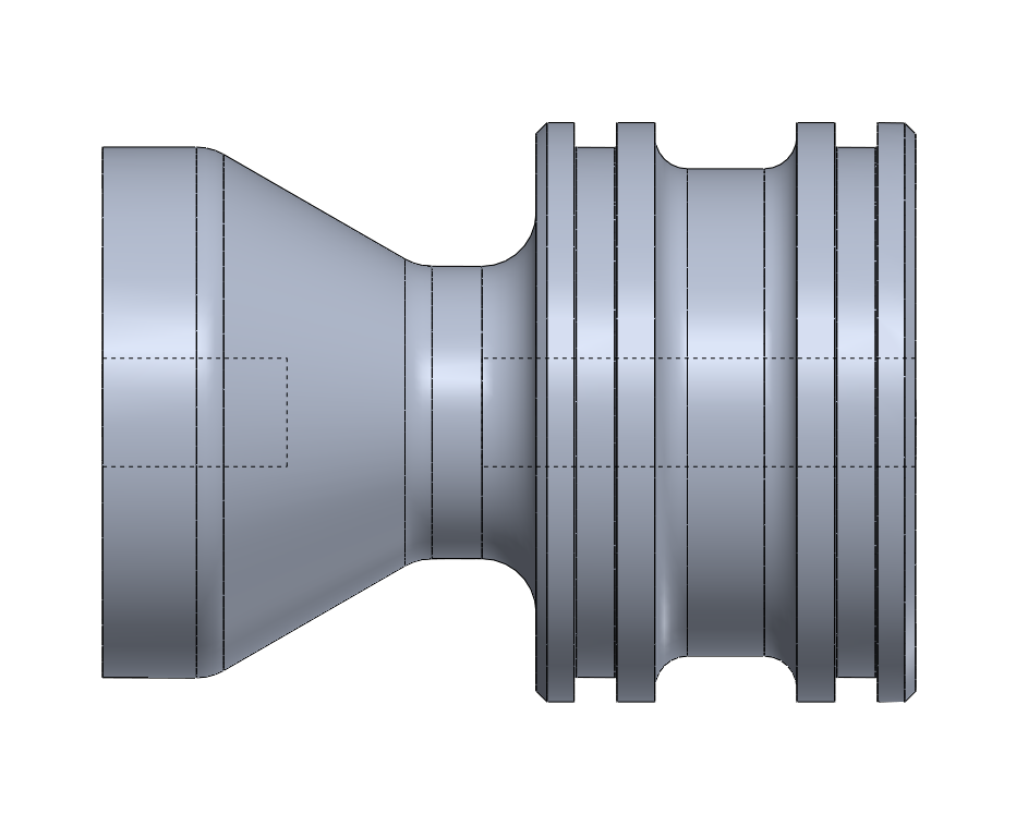

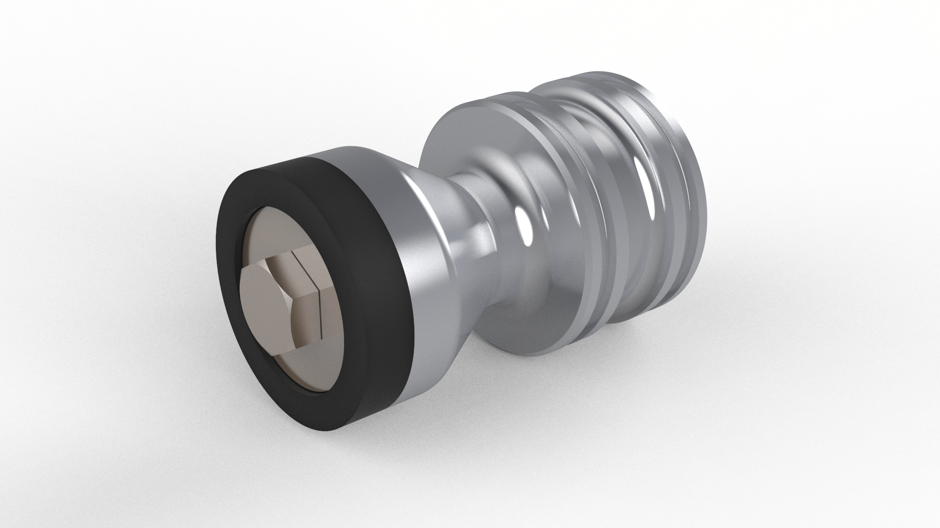

So here is where I am at the moment.

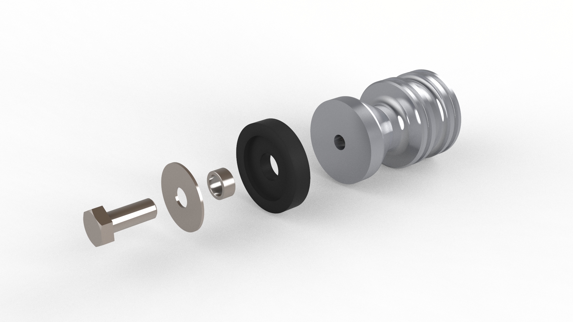

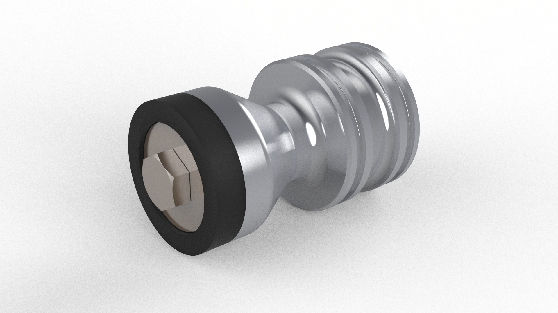

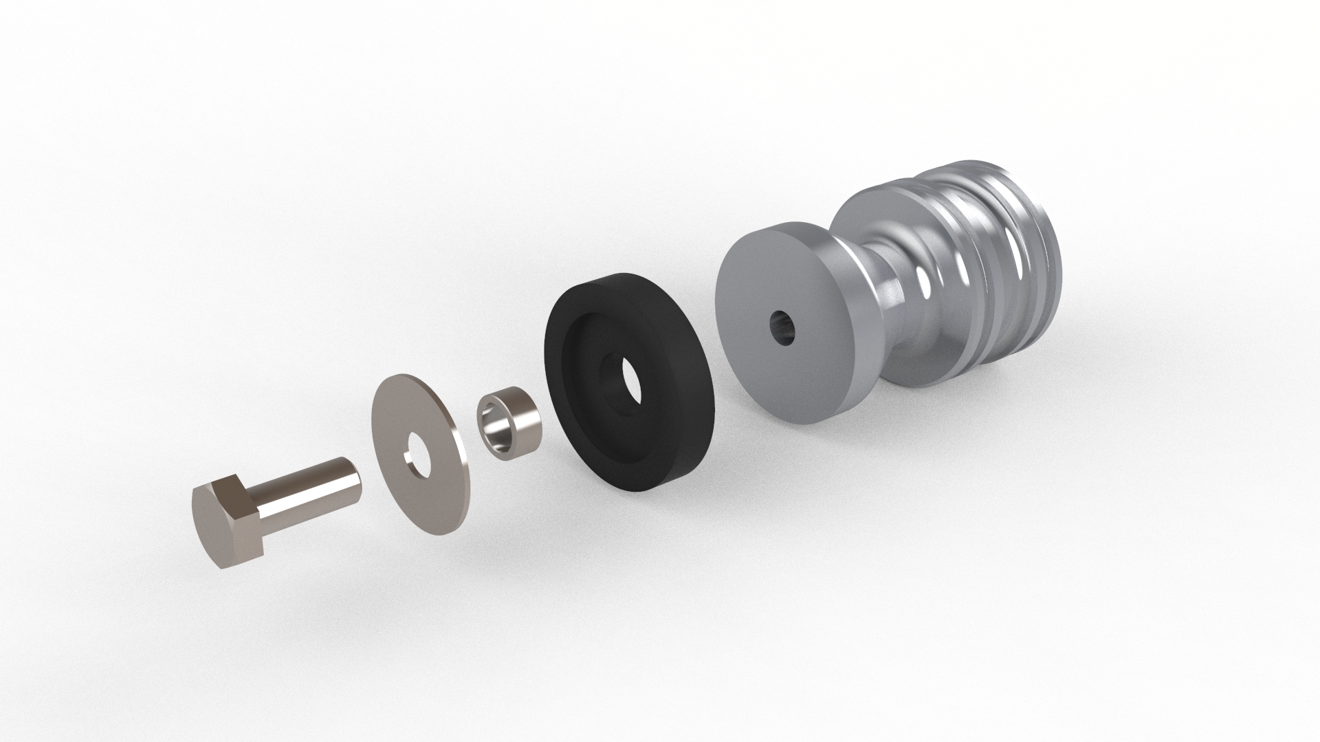

As recommended many moons ago I have added a large washer to secure the rubber face seal to the front of the piston. As before this is attached with an M10 screw.
Pressed into the rubber face seal is a sleeve to allow the screw to clamp the seal tight and not over compress the rubber
I have also moved the O-Ring grooves further apart.
Here is an exploded view for clarity :D
I plan on performing some more stress analysis on the piston before cutting metal, although I'm not entirely sure how to setup the analysis within SolidWorks (in particular what fixture face I should be using) - if anyone has any guidance that would be greatly appreciated.
Regards
Stuart

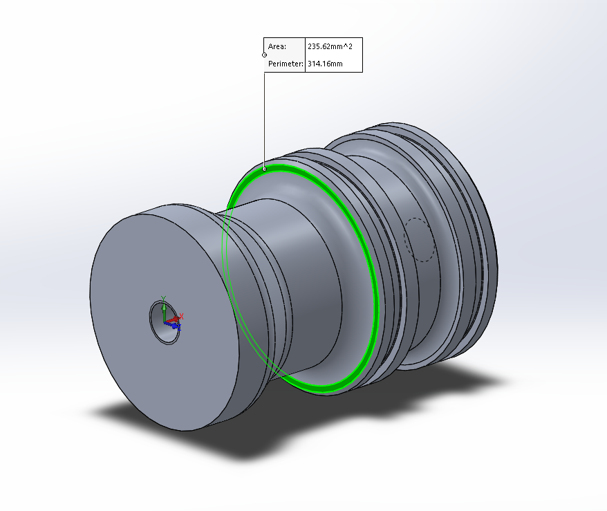

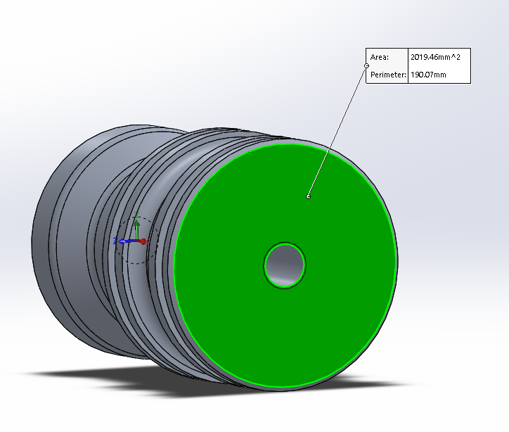

Something else I'd like someone's opinion on is the faces the chamber pressure and pilot pressure will be acting on
Apologies for the metric units but currently I have the following:
Chamber side of piston (235.62mm2):
Pilot side of piston (2019.46mm2):
I had a value of 1200 psi from HGDT for a 10x mix so I designed the piston to have a relatively small area to act upon (chamber side). WIth the current area of the pilot side (I can't really increase this) it requires a pilot pressure of around 133psi - from my calcs the pressure either side of the piston would equalise at chamber pressure approximately 1140psi.
Can anyone confirm this?

Based on your shown areas, I got 1143 psi chamber pressure for equalization, so the same that you got. It looks like this is an estimate though because it looks like you clicked the surfaces and there are chamfers on them, so the actual diameters will be a little larger, but it should be pretty close as it is. It also depends on the sealing face and if the whole rubber will be against the port. If the rubber diameter is larger than the edge of the port, then the calculations won't be accurate as the equalization would happen at less than the 1140psi because there would be more surface for the chamber pressure to act on at the front of the piston.

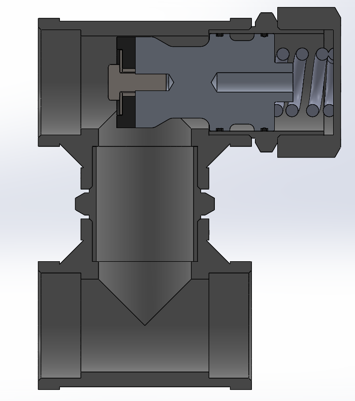

I also had an idea the other day about using a spring to keep the piston sealed. Has anyone done this?
Early concept, if this is a viable option I would need to resign the piston and find a suitable spring!
Obviously the downside is the spring isn't variable so a different spring would be needed for a given mix.
I'm also not sure how the spring would operate during operation. Would I get any valve bounce?
A threaded boss at the rear can increase or reduce preload on the spring within a certain range, although this will also reduce spring travel.

I did think about some adjustment to preload the spring, but I'm not sure I can find a suitable spring that would cover 1x to 10x mixes whilst also not reducing spring travel too much.
I'll continue to work on the concept and see where it goes. Thanks for your input :)
