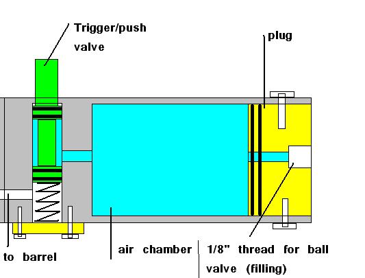

I want to build a launcher for my paintball gun similar to that of the scepter universal launcher. It will operate on standard paintball gun pressure ~850 psi. I want to make it out of aluminium.
I have designed a simple push valve for it that I think will work but am not sure. It is designed to have bad flow because of the high pressure. I don't want to go into buying regs and such for it to be low pressure because the gas source will be high pressure.
I am unsure of the design but it looks promising. Is there anything I am not taking into account?
The velocity should be adjusted by varying the volume of the chamber, maybe the plug for the chamber will be designed to have threads instead of being bolted in. I also think I will make a slide forward barrel for easy loading.

The valve system looks like it'll work... just as long as the o-rings will stay sealed at 850psi.
Is this meant to be a full auto design?
)DEMON(
Sergeant 4
Sergeant 4
Posts: 1391
Uh, no. I just realized why you asked that. The air chamber is filled once and fired once befor being filled again. So it is just single shot.
The orings should stay sealed, they seal in paintball guns at the same pressure.

you have a ball valve that is rated over 800 psi??

It has potential but I can see some flaws in the design.
The whole thing should be turned around and the bore for the ball valve should accept the barrel, and the one for the barrel should be used as a venting hole and you make it into a diaphragm or piston gun. Just an idea.

Did I forget to mension that I don't want to kill people with this? An 850psi piston gun will be a little overkill. The velocity for the projectile should be around 250-270fps, that is what is allowed.
I will get a ball valve meant for paintball or high pressure hydraulics. If the valve is small enough pressure isn't a big issue. The ball valves sold for paintball use are nothing special at all. Just plain brass ball valves. Yet they work fine for high pressure.

I suspect speed will be rather more variable than in an electro-pneumatic commerical type because of the manual opening of the valve.
If you add a lever or large button to the valve trigger to reduce the force needed to operate it then it would be more comfortable and easier to pull which could mean less variations in speed.

Yes I have thought of adding a lever to the valve, it will simply be a two finger trigger. This valve is very similar to a blowgun.

umm not sure if i have this right but i will just suggest it anyway.
that spring that holds up the 'green' push valve is going to have to be bloody strong to hold 850 psi and if it is strong enough how are you going to push it down it will be extremely hard to do i think.
but then again i mite have it wrong so i just thought id put up my suggestion just in case for you mate.
but if i have that wrong then thats all i can see so give it a go mate. good luck. :)
Ah, there's where you are wrong. There is equal force in the push valve, it isn't being force to one side, there's no way you will be able to exert 500kg of pressure with your thumb. Once the gas is flowing it will aid the opening of the valve.
Thanks for the comments guys, I have made a new design, ultra simple with one moving part only. Unfortunatly I am not sharing it. I have made a few pages of reseach and am discussing it with my freinds dad. He might be able to make it in his workshop.
It will be 40mm and use gas from the marker or stand alone. I hope he can make it. :D
