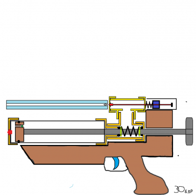

If you have to pull to pressurize, it's really not comfortable at all. For a pump you want to be pushing against a hard surface, especially if you don't have the benefit of a lever.keks2033 wrote:I know that this is not the most effective scheme
