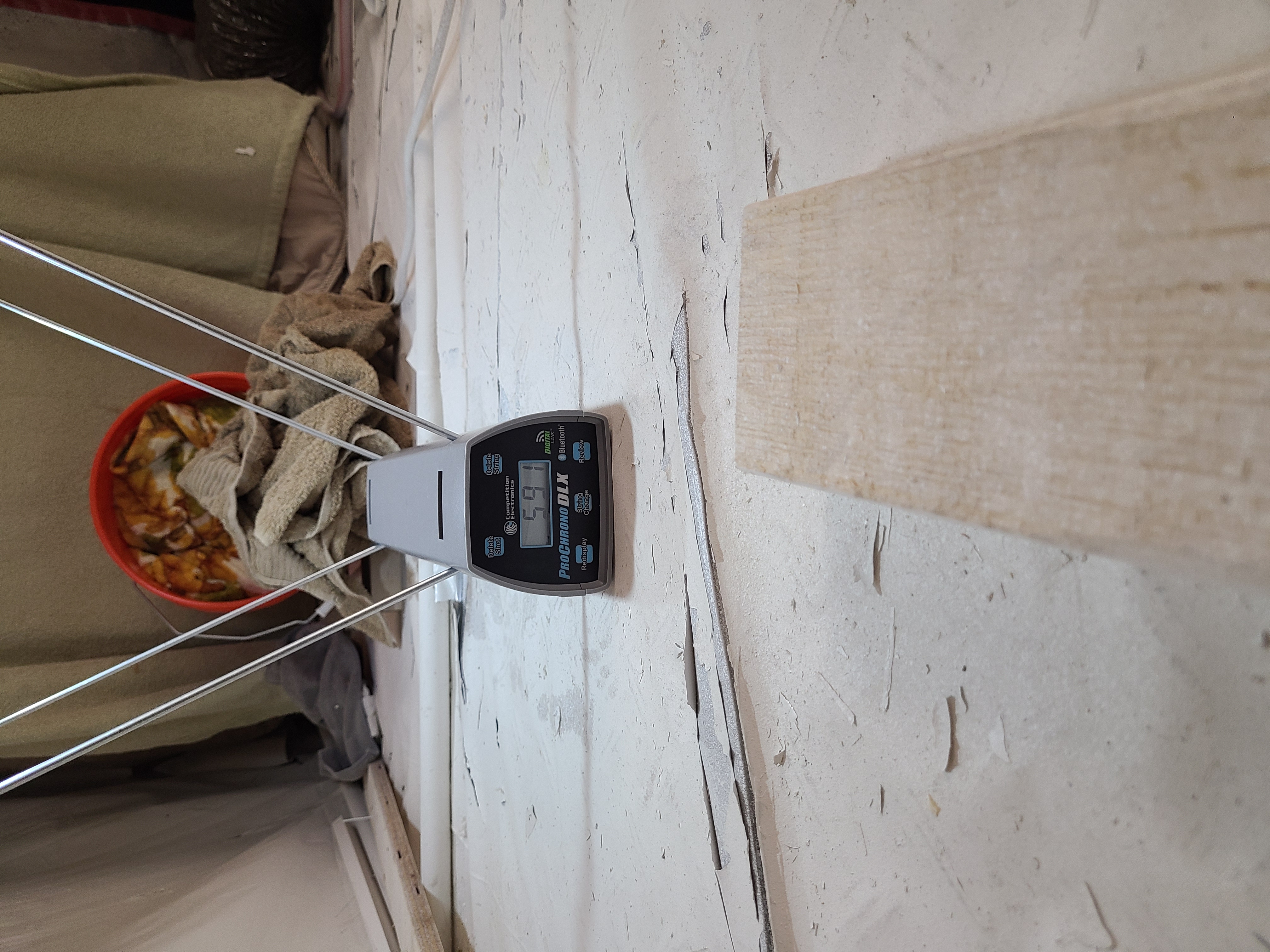

Using 3d printed sabot, and a 1/2" ball bearing, at 500psi I achieve roughly 590fps
Using a more aerodynamic 3d printed projectile, at 500psi I achieved 1009fps. Note, this was for funsies only, as the projectile weighed less than 2 grams.
