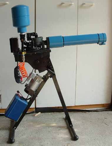

Here's my first attempt at a pneumatic cannon. I made it to fire tennis balls for my 9 y.o. son to practice baseball. So far I've only wired in the circuits so that the LED flashes along with a buzzer to countdown to the firing of the tennis ball. I've yet to set up the third circuit so the compressor starts and stops automatically. It took heaps of time to build but it was worth it. Anyone who sees us practicing wants a go.
The business end. That's an LED below the barrel end. It flashes and there's a buzzer to tell you when it's going to fire.

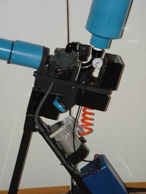

Left hand close up. The blue box houses the two 12 v batteries. The knob with the blue stripe (a car gear knob) is for adjusting elevation.
Right side view. That's the arm and fire switch hanging next to the orange air hose. It's a modified PC joy stick on a long lead.

On this smaller scale launcher, I’m really liking the vertical chamber hooked by what appears to be a long sweep elbow? Also it looks as if your got a ~1/4" solenoid valve? Just a few more questions if I may, the upper stand construction is wood, while the lower portion is a metal stand salvaged from something, or did you also build that as well? Also if I’m not mistaken you used a 'gear shifter handle' as to adjust elevation by inserting it into pre-drilled holes?

The only thing I see as being a problem is the fact that the chamber appears to be supported only by that elbow. Or is there something i am missing? Also that Reducer one the chamber? Is it pressure rated? It appears to be due to the thickness and the long socket length.

Thanks for the complements guys. :D I'll try to answer your questions. First up, I sprayed it blue after my son's team colours. All tube and plumbing are high pressure. The chamber is 95mm ID and the barrel is 65mm ID.
That is a steel elbow from the chamber to the valve. It suited the layout and gave me something to tap into for the gauge and the air line. I had to put the chamber up so I could get the elevation. Otherwise it hit the stand. You can put it nearly vertical and fill the barrel with water. Pump it up to 70 psi and you douse everything. You put a ball in as well and you never find the ball again. The stand is a modified roller guide I had for my Triton saw bench. It folds up and is height adjustable.
The 4WD tyre compressor is powered by 2 batteries from an electric scooter. They are 12V 4.5AH in parallel. One would probably have been enough. The box they're in is a spare water quality test kit box.
The elev adjuster was an old shifter knob. I modified it and sprayed it to match.
The circuits come as kits. One was an adjustable timer I modified to countdown from 4 secs. It activates the other which is an electronic metronome which I modded so instead of clicking each second it would activate a buzzer and LED together so you get visual and aural count down to firing. The top button on the joy stick sets it all going. On the fourth beep/flash you pull the trigger to fire it.
