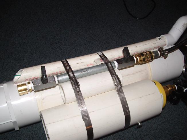

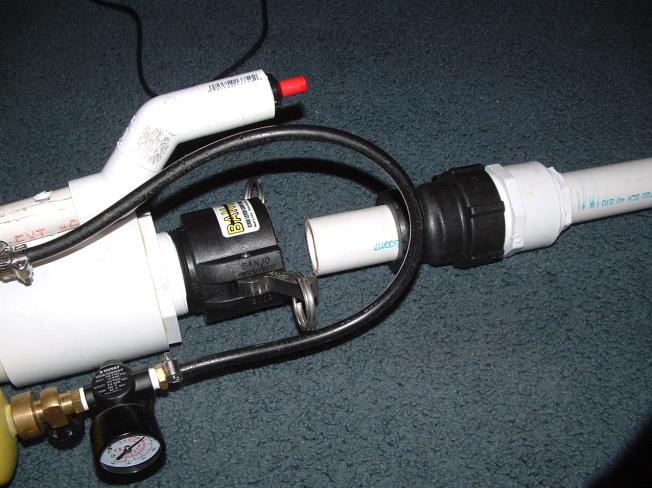

Last Blast Junior
Posts: 3643
Been thanked: 62 times
Last Blast Junior
Barrel: 48" x 1-1/4" SCH-40
Chamber: 15" x 3" SCH-40
Connection: breech-loading cam lock barrel
Mixing: Ozark Trails camping fan
Fuel: Thumb-operated MAPP meter
Ignition: single-gapped BBQ sparker handle
This is just a little gun I came up with this week to provide a more portable combustion cannon for me to use. Decided to build it after wanting another "small" gun. Here's a few pictures.

Very nice, but you should build a sparkstrip for it. My bbq ignitor can easily handle 3 good-sized sparks, and the preformance went WAY up. It went from boom to BOOM

I personally don't really bother with dual ignition anymore. I find that one gap at the back of the chamber works great for me. My first two serious cannons had dual ignition, and they're not anymore powerful than the LB and now the Junior. I still think that pressure rise is equal across the entire chamber, regardless of the position of the flame front(s).
