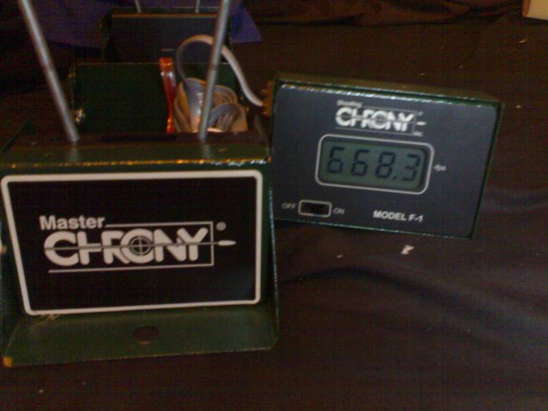

did a small chrony test at 80psi with a small aluminium slug
the results are pretty promising but i had to stop shooting as this thing is really loud and i dont really want the cops called lol
more tests to come....

Oh it can go faster then that. Take it to 110 psi and get in the 700's.

im sure it can go faster but the bike pump doesn't wanna go any higher lol
i was pretty much pushing my full body weight on it and it wouldn't go down lol
i'll hook it up to the compressor one day and do afew more tests, with some lighter ammo too, see how high i can get it lol
100psi alloy slug<br />thats 733km/hr or 455 miles/hr
100psi alloy slug

Sooo close to 700. Dang thats very fast. I believe that if you where to use a light weight areodynamic bullet that at 100 psi it would go over 700.
