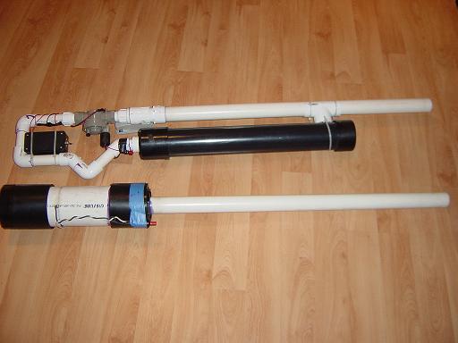

This is my first combustion & pneumatic spudguns, thought i would share them with the world. i started with the combustion, nothing fancy or flashy. this guy is alot of fun. i use starting fulid as a proprlent. the black piceses are abs because its hard to find pvc reducers and cupplings in Hawaii.

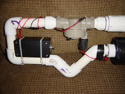

The pneumatic over under that i just finished (never shot) took me about a week to build. i tried to fill it with a small hand pump but could not get any pressure to build up. its to hard to do it by hand and i dont have a air compressor. dont know whats wrong? the solonoid fires and i built the batt box with parts from Radioshack. can anyone help me with the proplem i have.[/img]

Nice cannons, Is that ABS on the pneumatic? ABS is bad for pneumatics, but fine for combustions. Unless its the rare pressure rated stuff I wouldnt take it above 40psi.
Now for the solenoid problem. For better performance,less money and a cooler gun, get rid off the battery box and solenoid. Fill the solenoid hole with epoxy and mod the valve with a blow gun. See the how-to section for that as its stickied at the top of the page. The reason you can't build up pressure is because the valve needs about 20psi-ish to close it and stop leaking, so you need to pump bloody fast or get a air compressor.

nice gun but yah modify the sprinkler valve and it will do better

Nice cannon, did you see it on PVC ballistics? Well if thats abs, you might want to replace that part with some nsf-pw.

nice guns. the one is pretty complicated for a starter gun though. my first gun is like the second gun only mine had a grill igniter on the back of the chamber. nice job 8)
The first gun: Switch that ABS to pressure rated PVC NOW! ABS isn't pressure rated and is a potencial hazard.
The 2nd gun: Never glue ABS to PVC, even using the Universal Cement. Use threads if you really need to.
Other than that, they're pretty good for your first ones.

Yeah besides the ABs, they are some good looking guns!
Thanks for all the advice spuddies.
to answer some questions, that is abs on the pneumatic gun but its has SCH 40 on it, is it still safe to use? the only reason i used it is because it was affordable and if i was to buy 3" PVC here in Hawaii it cost about three times more than the ABS SCH 40.

You don't really NEED to get an air compressor. I use a bike pump for my pneumatic, and it works fine, but the piston starts bothering me at around 70 psi. Nice guns, a lot better than my first.
A modded sprinkler valve will help a lot. You will love it and want to marry it and name it George.
