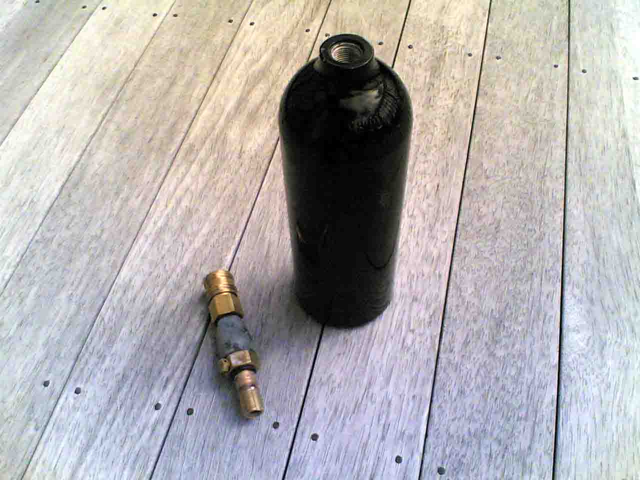

Ok I made it the other day. I decided that It would be easier and better if the JB weld was fixed in place, so I cant unscrew the threads.
I modified a pin valve on a paintball tank to allow more flow and I JB welded it to a 1/4 inch coupler which then screws into a air compressor quick connect fitting. So now I have a paintball tank as a chamber. Now all I have to do if make a barrel and trigger system for a gun.

This is the pin valve and PB tank I modified that is JB welded to the quick connect fitting

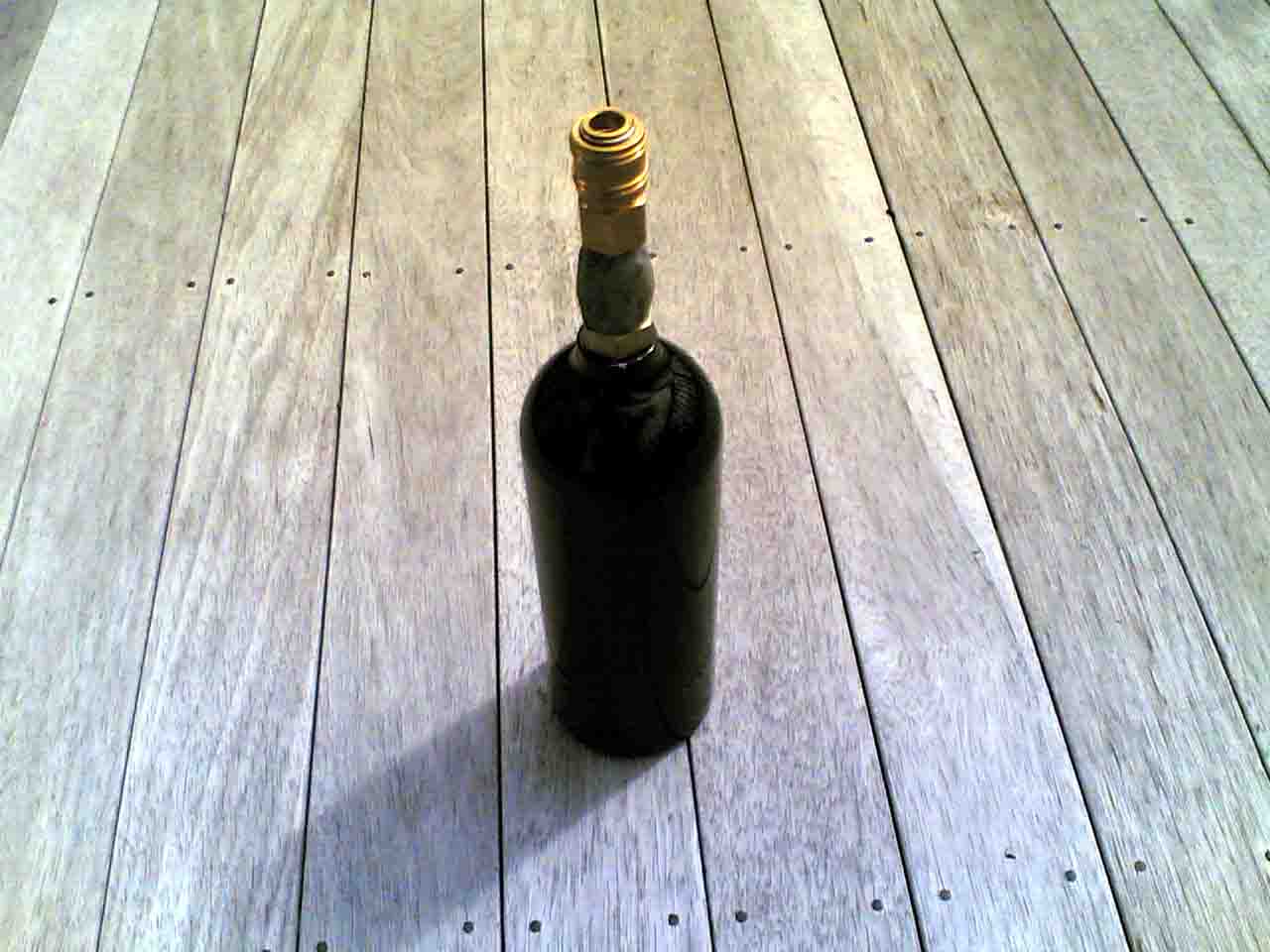

This is my modified pb tank complete with quick connect fittings.

Have a look at my first post and you will see my completed product. It doesnt look as ghetto as I thought. It feels pretty sturdy, the max I would take it up to is probably 250psi. After a few trials I may decide to sleeve it with something for safety.
