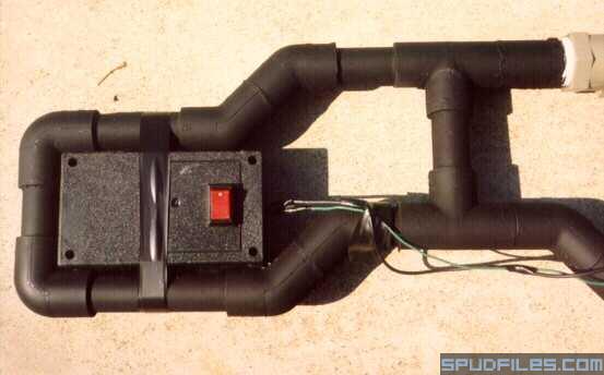

This was the FIRST (funny, huh?) pneumatic cannon that I built. I saw the design on Xinventions.com and realized that the cannon would have to be modified (A LOT), to get it to my own personal safety requirements and specifications. I later saw the one on the XArchive and decided I liked that design well enough to build it. I went out and got the materials, built it and it sucked (a MAJOR leak), so I salvaged what I could and built a new one. I modified all the other versions since mine has one air chamber, a gauge and air compressor hookup, and I used different electronic stuff and different items for the breech loader. This is the cannon that should be built by an experienced person, as there are many joints and places that could leak, blow out, etc. It takes a long time to build and costs a higher price than the previous pneumatics. Nevertheless, I like this cannon because

It should be pretty self-explanatory on how to assemble this air cannon. Prime and cement all joints just like in the pictures, and you better make sure they all go straight. One method of achieving this is to first glue the fitting onto the pipe, then quick jam the whole assembly down against a table, turning the fitting just enough to get it straight. The other method is to test slide the fitting onto the pipe (before you use glue), align it where you want, then draw a little mark with a pen somewhere on each side. When you glue it, turn the fitting until the marks line up. Electronics should be wired in series, and soldered for efficiency.

Here's a close-up of the stock on the gun. It fits comfortably into the shooter's shoulder, and the stock keeps the battery box from being accidentally turned off. The back half of the stock isn't even pressurized. I used gold dollars as stoppers to keep
