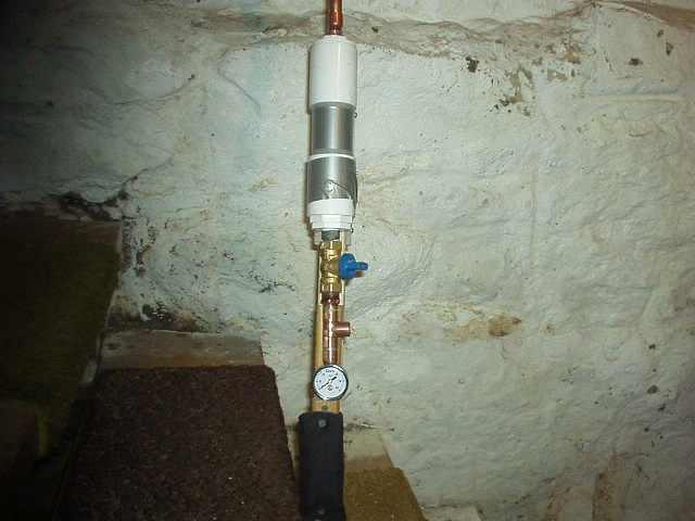

As an update for you guys:
I have decided to go with 1/2" copper for the barrel and the chamber is still going to 1.5 " PVC. I havent had the extra money to buy all the parts but i just got a bunch of copper from my father-in-law, so that helps. I just need to buy another 20 or so dollars worth of stuff before I can get started on this. I also revised the plan for the metering. When all is said and done this project will certainly fall into the mini combustion catagory, but should be alot of fun. I'll keep you posted as I make progress.

dont have all the parts to finish it yet, and I broke the stock that I had made so I went into the cellar and started making a new stock and tried to dry fit what parts I do have to get an idea of how this is going to turn out. I took a few picks for you, maybe on payday I will pick up the rest of what I need so I can get serious here. Here is my unfinished meter and a very crude dry fit. and my new unfinished SVD stock

I decided to change the meter to a completeley different setup, instead of going over the top of the barrel with a meter tube i drilled a hole in the chamber tube and inserted a valve stem from my spare tire, hope I dont get a flat anytime soon.

. Here is another idea that I was toying around with, the meter from my other cannon is made os 1.5" and its 7 " long. if i left the barrel at 36" long I would have a C:B of 1.33:1 or I could cut it down to 24" for a 2:1 C:B. Decisions, decisions. I like this setup here, and i think im gonna go with it. less parts to buy.
