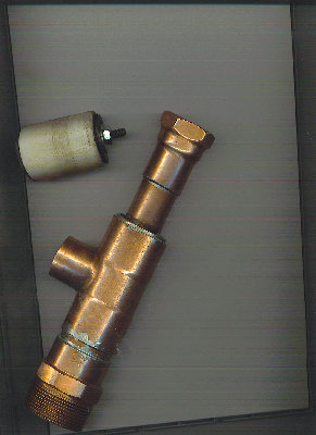

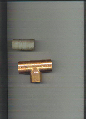

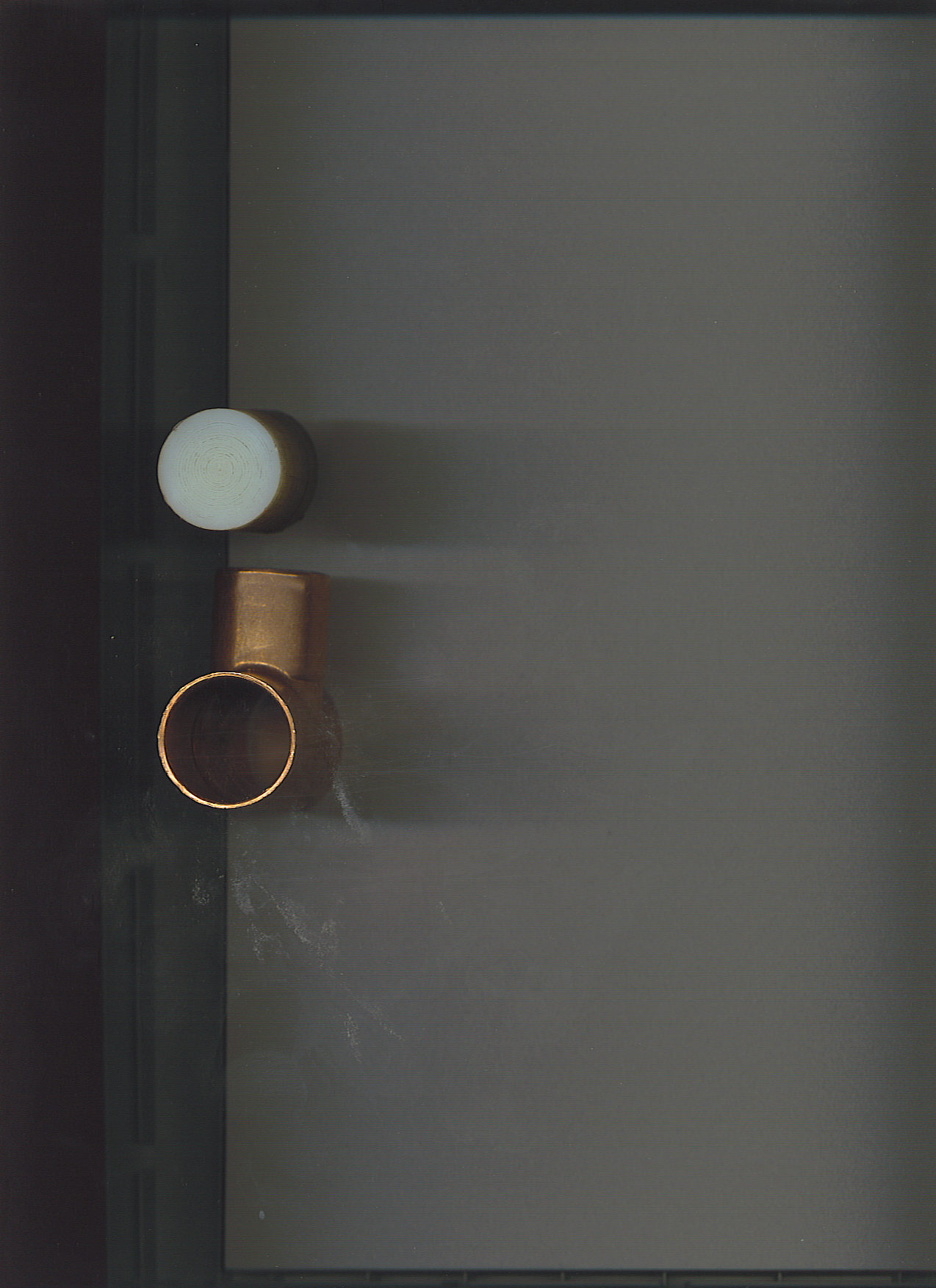

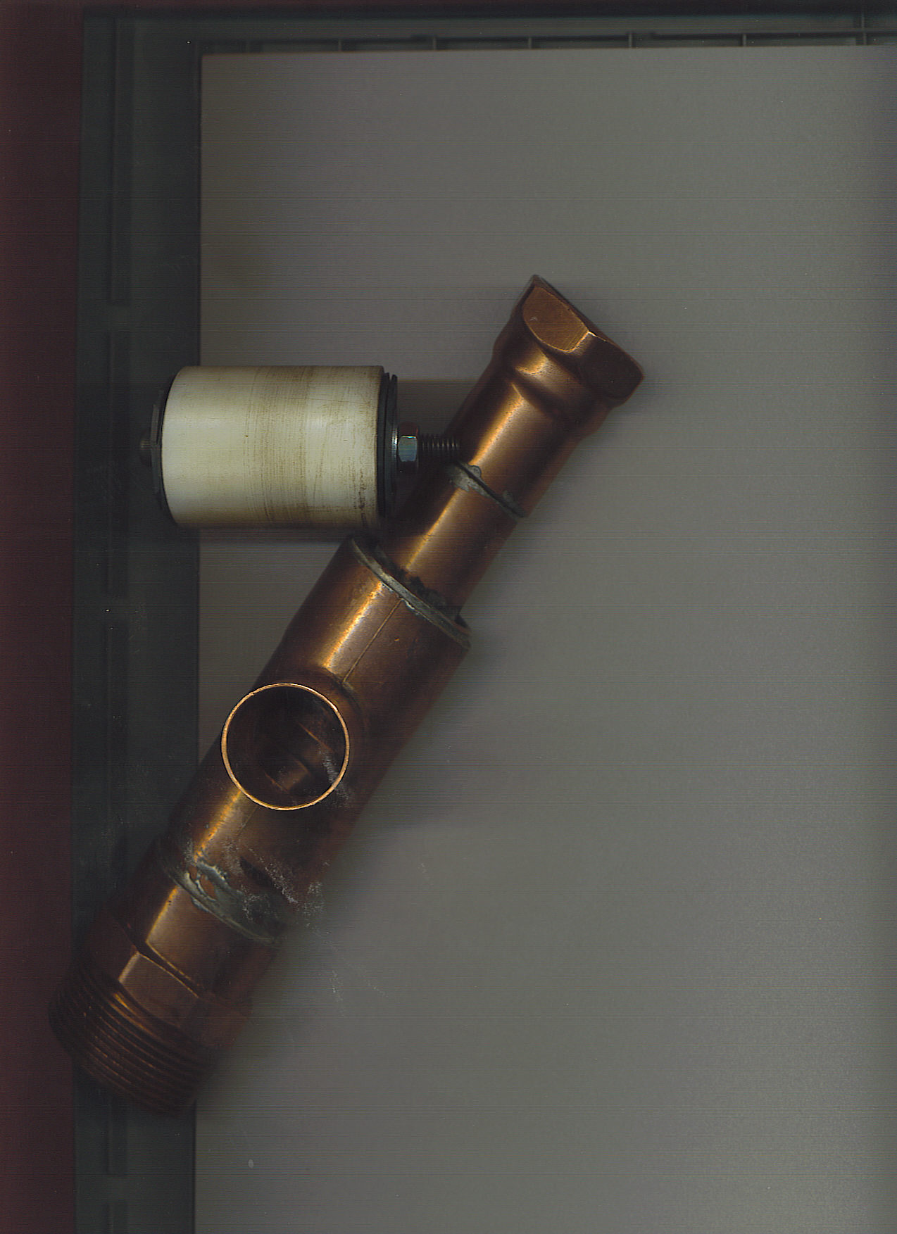

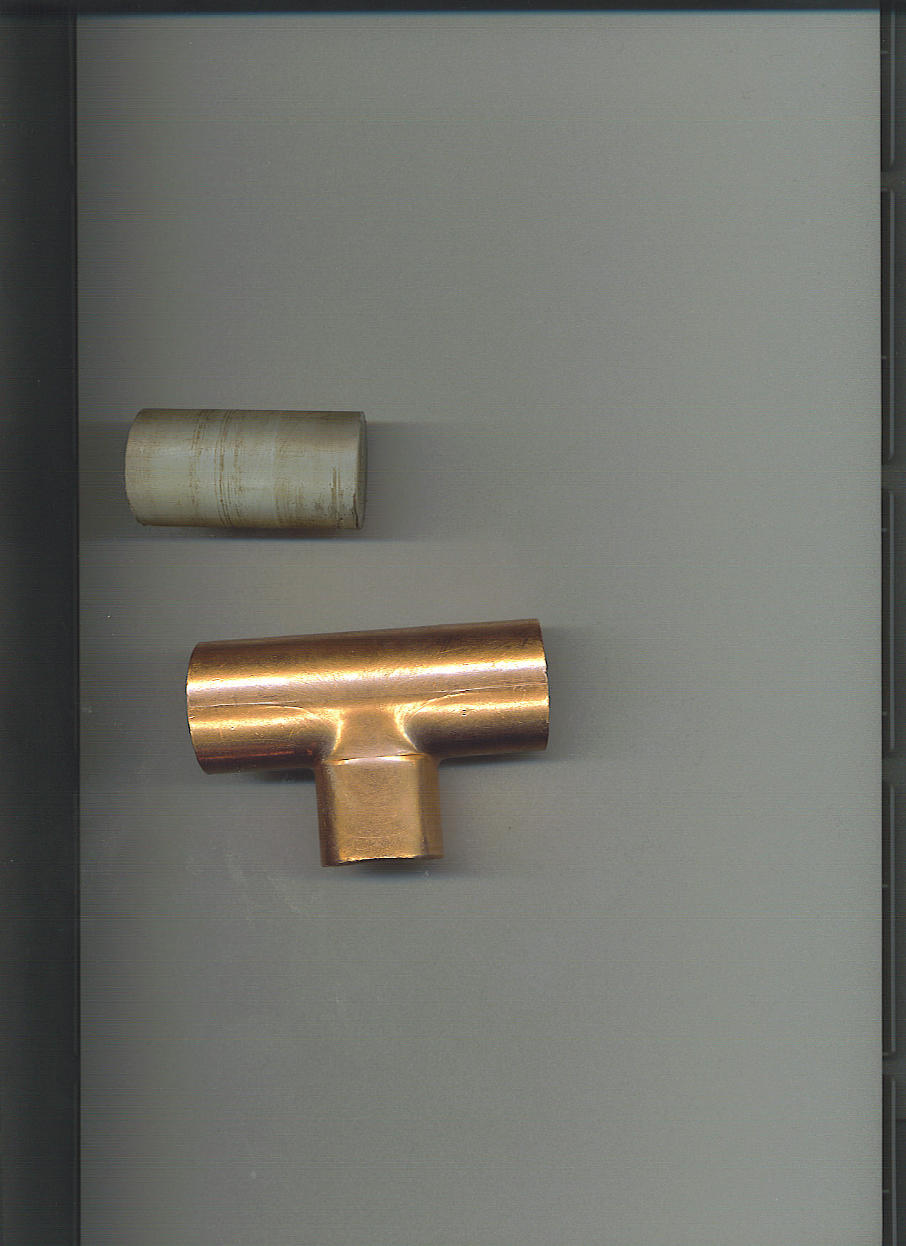

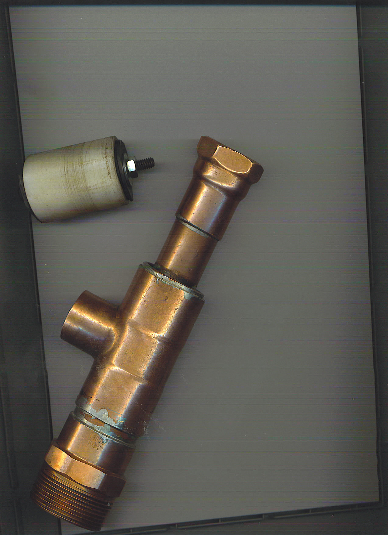

ok well im making a piston for my comp gun and idk how i should do it...i have already got my piston it is teflon and i have rubber to but....idk how to hook the tee that the piston is seated in up to my pipe...the piston just fits in the tee and not in the 1" pipes...i need it to seal the the barrel but move enough so it will open and seal...with the pipe into the tee the piston cant move...how small can i make the piston so it still works??i am going to only solder the pipes half way into the tee but it still only moves minimally......god someone please help me i am going insane..

sh*t!!!!!!!i forgot about access at it wtf!! god damnit how the hell am i going to do this....is there a simpler way??i found that 1 1/4 inch pipe fits over a 1 inch tee could i solder that on then put a 1 1/4 inch to a 1inch reducer and for the back have something screw on it for access if i needed it??? would this work??post suggestions..
edit wtf i need a whole new concept becuase if i do that i would need a stop and i still wouldnt be able to get at the piston.....omg someone help here is my setup now without the rubber i ddint put it on yet...
...pics are in main post
yes you could do that, but if you put a reducer on you cant get the piston out (if the reducer is on the back) if its on the front, where the barrel goes, it will be ok, assuming that you are using copper pipe.
It sounds like you screwed it up pretty bad. maybe if you gave a couple picture we could help a little more, but the way you are describing it, it sounds like the best thing to do is start over. Before you even glue/ solder anything, check and see it it fits right first.
I just had a possible brain storm!!!! you said to were soldering it right? just heat it up again and melt the solder and take it apart with pliers.
edit- sorry didnt see the pictures, ya just heat it up again with a blow torch and take it apart.

i kinda cant start over i spent over 150 on this gun and if i cant get a piston or anything else i am thinking on a qev...theres more effing money!!!!!!please please please someone help me...
You need a reducer for the barrel side and a fitting with a threaded opening larger than your piston for the back.
Then just lathe your piston down so it slides in the one inch pipe.
I'm not sure why you thought it actually slid in the t itself.
It is probably easier to buy a one inch t with a half inch reduction on one side for the barrel and then use a bushing to take the piston side down to 3/4. That way your access port isn't so bulky and your piston can be smaller and lighter.
Make sure whatever fittings you screw into the back are threaded all the way in and positioned correctly before you attach them.
It would be just your luck to attach the fitting and then find out that fully tightening everything leaves the assembly upside down or pointing out the side.
ill try to explain this the very best i can.
Take about 3'' of you barrel and use a bushing to put it into the tee about half
way in. put a piece of pipe the same size of the tee in there and that is where the piston sits. The way you have it now, the piston sitting in the tee itself, wont work if you want to take it out. the piston neets to be in a piece of pipe, which needs to be in the tee. this will allow you to take it out.
By the way, the barrel need to be t least 1/2 inch smaller than the tee, and it need to fit into the tee about half way. so if you have a 1 1/2 inch tee, then the largest barrel you can have is 1''.
hope this help, if you have any more unanswered questions, feel free to ask and ill help the very best i can.

i dont really understand how to do this...so i would use the piston i have??the teflon one?? and how to i get the barrel to do that...my gun is using a 1 inch barrel....and i wanted them to be interchangeable barrels...so i have to solder a female copper adapter on and that design wouldnt work...unless i had a bigger to to fit the piston into...i have no clue how this is going to work....
- jrrdw
- Posts: 6572
- Location: Maryland
- Has thanked: 39 times
- Been thanked: 22 times
Rite. all the way around. Now the discision is up to you. You could build a bigger piston for a bigger tee, that will allow the use of 1" barrel. Time to decide, the contest is coming up.spudthug wrote:i dont really understand how to do this...so i would use the piston i have??the teflon one?? and how to i get the barrel to do that...my gun is using a 1 inch barrel....and i wanted them to be interchangeable barrels...so i have to solder a female copper adapter on and that design wouldnt work...unless i had a bigger to to fit the piston into...i have no clue how this is going to work....
