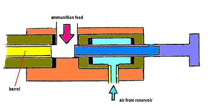

Hey Jack, whatever became of your design for a .22 pellet gun that used a hammer to knock the bolt forward, simultaneously loading a pellet and allowing air in through holes in the side of the bolt? You said it broke but then you changed somehting and it worked, and you had ordered a solenoid to run it, and that was it. (This was all on the spudtech archive, btw.)
Also, how would the power of that gun stack up against a single-shot piston? Seems like the restriction of the holes would cause lower power.
Jack's semi pellet gun?
I had got the solenoids, here, I even made a little "animation" to show how it would work:
Unfortunately, the solenoid didn't have the stamina to operate it against the friction caused by the seals. Basically, the theory is sound, but in order to operate effectively the "bolt" portion needs to have grooves machined into it for the fitment of o-rings that would provide an effective and relativley friction-free seal.
Honestly, I really need to stop half-finishing my prototypes
Of course the power would be reduced when compared to a single-shot piston launcher, due to the reduced flow and slower opening valve - but then again, you'd have a lot more lead at your disposal so the effect on target would be more impressive.
For those of you who have no clue what we're talking about:
- breech cutaway with bolt open and vents closed (loading)
- HAMMER2.JPG (27.21 KiB) Viewed 12171 times
- breech cutaway with bolt closed and vents open (firing)
- hammer.JPG (32.78 KiB) Viewed 12171 times

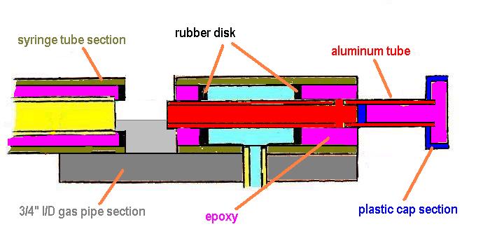

None at all, I don't have a lathe so it's all epoxy castings. i attached a breakdown of the materials I used.How much machining did it take?
Will it, really? and with how much more power? There is no such thing as too much power, but power is a terrible thing to waste. I'm all for adding more power, as long as it's all used up.Back to my first statement, and your post, if that’s true, why is it that any American muscle car will out perform an import racer any day? There is no such thing as to much power.

If it’s all epoxy how much pressure can it handle?

How much trouble would it be to cast the epoxy with an ID o-ring groove? Seems like you could lube up your bolt with grease, slide a wax ring on it, and cast the epoxy around it. When it's all done, squirt some boiling water in there to get the wax out, and stuff a little o-ring up in there.

I'm not a fan of BBMGs purely because they're so wasteful of air, which is why after making my own vortex and cloud designs, I came up with another version free of dead space that was much more efficient, and gave me over double the muzzle energy for the same pressure.judgment_arms wrote:Actually no I haven’t noticed how much you hate them, you’re rather new, and I don’t click on many topics about BBMGs. But I don’t blame you for not liking them, I don’t even like the vortex BBMGs.
In my mini-coaxial, I've taken the pressure up to 400 psi without ever having a failure, basically the PVC will fail long before the epoxy does. It's all a question of using string adhesive and applying it properly.If it’s all epoxy how much pressure can it handle?
