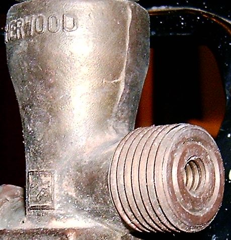

What type of valve connection is on my CO2 tank
I got this tank from work, they were going to toss it out because no company laid claim to it after the plant closed down. So I grabbed it for free and it's almost full.
The reason I asked is my boss gave me a Argon regulator (again for free), he said it will work with CO2 but the connection is the wrong type.
If my memory is right it's a 1/2 in pipe thread that is not tapered.
It seals on a gasket in between the gauge connection and the bottle.
a welding supply store should be able to change your gauge inlet fitting( fairly cheaply (not for free though)

Is the hole in the middle also threaded?
@cdheller
The connection measures 3/4 of an inch
@From_Hamsterdam
Yes it's threaded in the center and it's 1/4 of an inch

hmmm i being a welder myself suspect that the regulator for "argon" will not work for you.
argon regulators usually regulate lpm (liters per minute) not pressure (kpa, psi ect.
but damn nice valves n stuff u have there and u seem to have more than enough gauges also.
good score
peace
chaos
good score
peace
chaos
yer it will work at 2500psi (maybe a bit higher) 3000psi is on the limit. i got two of these here at mi house one is on an argon bottle, these regulators only control flow, not pressure. soz but you might want to get a different regulator. HERE is a regulator for both CO2 and Argon but as i say again it only controls flow not pressure. your Regulator will display the correct pressure in the tank but will not give you any useful pressure for a pneumatic gun.
peace mate
chaos
