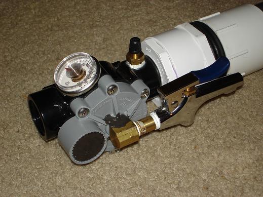

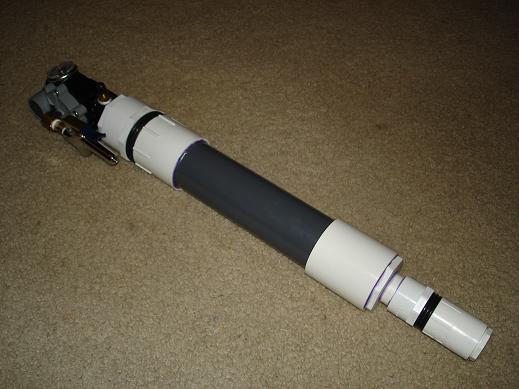

I just finished making a few improvements on my mini piston gun. They are:
-A smaller, lighter piston that sits farther back in the gun giving it a bigger chamber and longer barrel.
-A 1" sprinkler valve as a pilot (which in proportion to this gun's size is a HUGE pilot).
-A blowgun trigger instead of a ball valve.
I also tapped the schrader valve and pressure gauge into the sprinkler valve to keep the gun as "low profile" as possible.

That is a REALLY nice trigger/fill setup!
Great gun overall.

Wow, the best part of your gun is the trigger/fill setup. Probably one of the nicest setups I've ever seen. Simply beautiful!

Thats genious! My favorite part of the changes is the pressure gauge in the side of the sprinkler valve. Ive seen the gauges before, but the center-back connection gauges I get have a large profile. Looks ergonomic to hold, and fire. I seriously might copy you, I'm pretty sure I have everything, possibly look for a gauge similar to yours, but thats it. Hmmm got me thinking...

wow...... that sprinkler valve actuation on such a small piston must be POWERFUL! and the way you hooked that all up...... wow....... YOu should go to plumbing school

i really like the tapping of the sprinkler valve for the fill valve and pressure gauge, really good idea
i may have to steal it for my sniper im building
