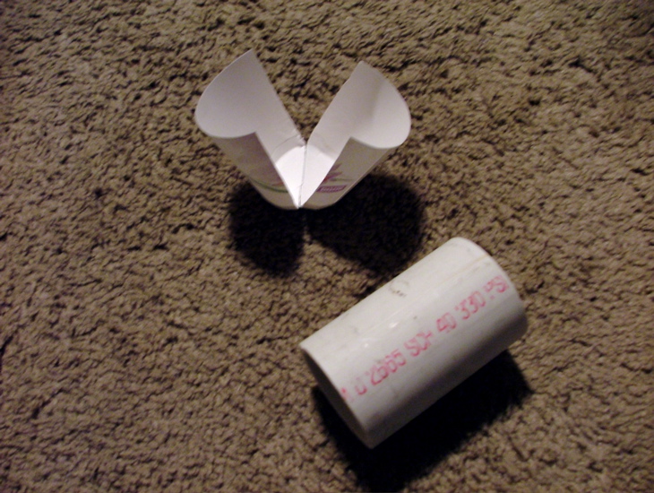

FRAG stands for Fast Reloading Airpowered Grenade launcher. I am happy to bring you my new cannon designed not for power, but for safe use on an airsoft field. This is a breech loader as you can see below, and it utilizes the sliding barrel breech loading system. The barrel has no need for a latch to keep it from blowing forward, because the barrel is held in by friction (it opened the breech at 110 psi, but who cares...it made getting the shell out alot quicker). It is also built entirely out of NSF-pw and is safer then my old cannon.
Specs:
chamber: about 7" of 2" sch 40 pvc
barrel: about 12" of 1.5" sch 40 pvc
valve: 1" watermaster modified sprinkler valve
pilot valve: modified husky blowgun
The pics below are self explanatory.
It shot 150ft pointing it parralell with the ground at 100psi. It has some kick.
breech closed
breech closed
breech open
breech open
shell with sabot.
shell with sabot.
bbs in shell
bbs in shell
preparing shell
preparing shell
preparing
preparing
loading

Just one Question, how did you make the connector big enough for the barrel to slide through? Do you have a lathe?
mega_swordman
Posts: 526
That is a very nifty cannon. I really like that kind of breech loader, as well as the sabots. One topic that is constantly touched is: it could use a paint job. However, since you did such a great job on the priming, it looks good even without the paint.
@turbohacker: I'm pretty sure that is a 1.5" T-joint with the stops sanded down so it can slide through.
origin unknown
Posts: 533
It is a coupler sanded down so the barrel slides through clamped with a hose clamp onto the chamber.
origin unknown
Posts: 533
turbohacker wrote:Just one Question, how did you make the connector big enough for the barrel to slide through? Do you have a lathe?
I cut the inside of the coupler with a pocket knife and sanded the thing out to make it smooth. It didn't take but a couple of hours to do.

origin unknown
Posts: 533
I was instead thinking of having a small bike pump mounted to the chamber, which would be cheaper than a CO2 setup (It is easy to pump the whimpy chamber up to 80psi with a good pump). If I ever do get a CO2 setup it will be used for my Vortex Gun.
