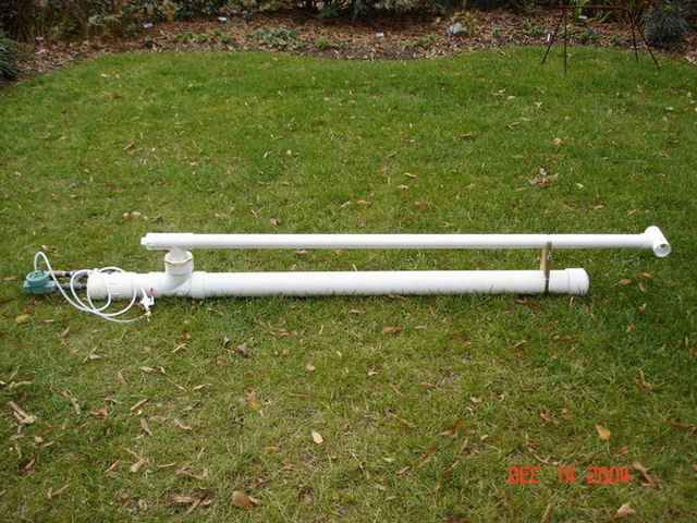

Here is a cannon which I like to call the mini LRPL-01, it uses the same principle as the much larger and much more powerful original LRPL-01. It uses a piston valve like other cannons exept for the fact that in the 3" tee there is a 1.5" peice of pvc pipe with an elbow on it, this is what the piston pushes up against to seal, thus the barrel is no longer inside of the chamber. This allows more air to be stored at about 60 psi in it.
I think that it possibly has a velocity of about 450 fps with the correct projectile at 60 psi, it uses a 3"x6' chamber with a 1.5"x6' barrel. It also uses a modified sprinkler valve to fire it, to fill the gun with compressed air I used a direct connect fitting that directly (obvously) attaches to the air hose, this allows more air to flow into the gun, thus charging it quicker, I also used a small half inch ball valve to control that flow of air

why is there a tee on the end of the barrel?? is there a hole in the end of the tee
