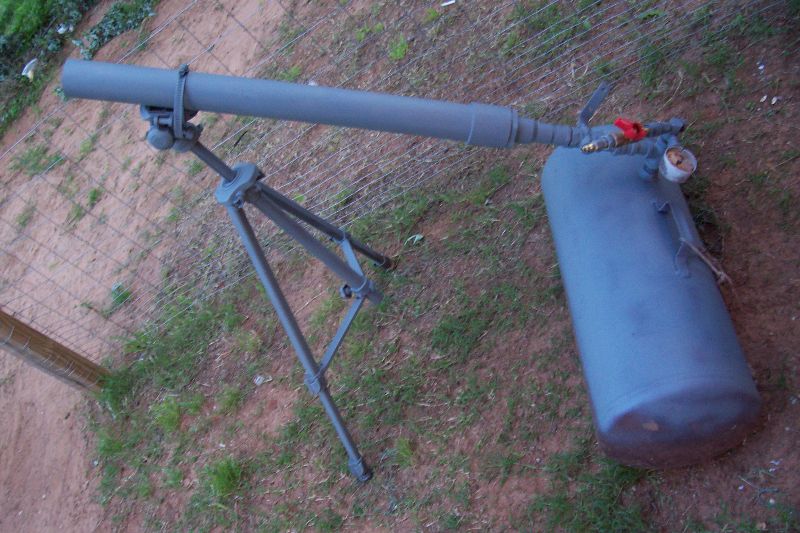

Also when you may want to add a faster opening valve to the list of things to get. Or perhaps find a way to actuate the ball valve a bit faster? I think there is a guna round here that uses a spring and a pin. If you could attach the pin to a string and use that to fire it that would be really cool. Anyway, nice gun and nice bipod.

That sounds interesting ShowNoMercy, my next mod will be a better valve along with a new paint job of desert tan prolly. I will look for guna's rig, thx.
There are several rigs around here using spring acuated ball valves. I've built one myself. You should either upgrade the ball valve size significantly or get a sprinkler valve.

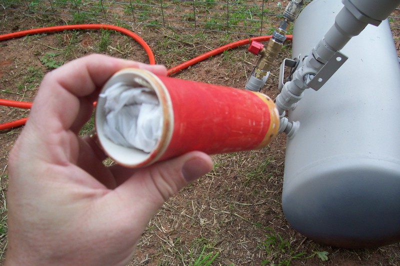

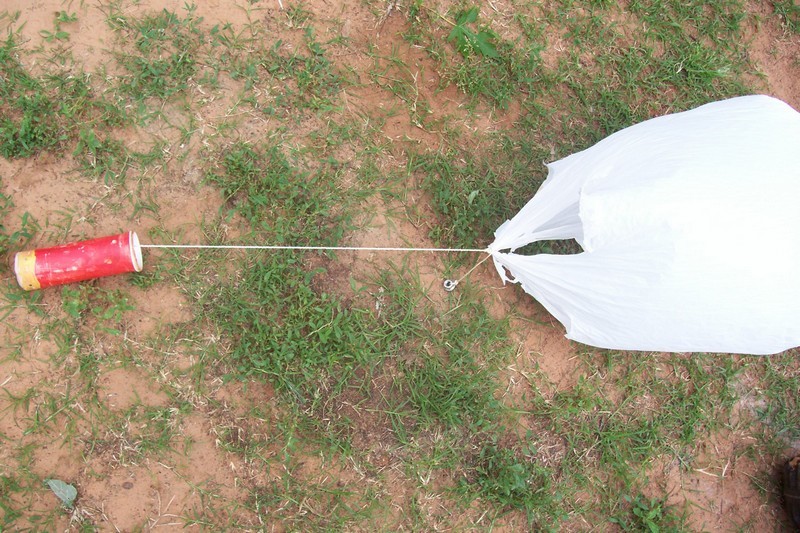

I made a parachute round by drilling a hole in the base of the shell and tying a piece of trot line to it and attaching it to a walmart bag and a metal nut so it will pull the chute out. it deployed too soon but still went pretty high and floated down. i have a video as soon as i can get it uploaded.

heres a couple screenshots from the video just in case someone wanted to see. im gonna check out the water rocket rigs jimmy, thx.

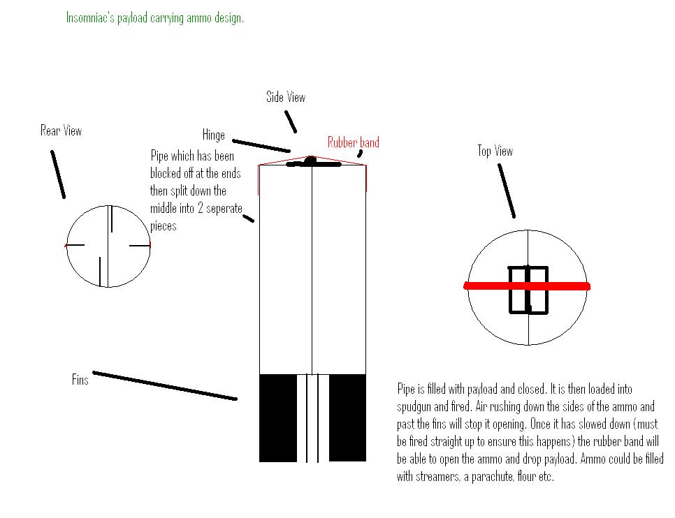

I have designed a parachute round, but I haven't built it. I sent a diagram to spudblaster15, who has built it but hasn't posted it yet.
Here is a diagram.

Insomniac, i like your design that would proably be better

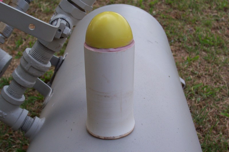

Here is my 50mm shell for my 2" mortar. I used a 1 1/2 " pvc shell with a plug in the top, then i filled half a plastic easter egg with bondo and bondo'd it to the top.

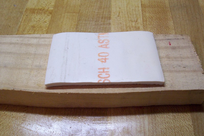

This is my first attempt at making a flat pvc sheet out of a 2 inch pipe. This could be used for several different projects. First i cut a short piece of pipe in half then put it in a pot of boiling water for about 15 minutes or so. this softened it enough i could place it on a flat surface and hold a board down on it for a minute.

very nice projectile, it would be awesome to have some LED wired on it, and maybe some clear pvc

You can buy sheet PVC at well equipped hardware stores. Check in the moldings section, it is being used more and more for exterior trim on houses since it outlasts wood. But, PVC sheet is much more expensive than wood. I don't recall anyone ever making it from pipe like you did.
The flattened PVC pipe could come in real handy for fabricating stocks, grips, carriages, etc.
Do you think your 2" round is aerodynamically stable? Is the Bondo filled nose heavy enough to get the center of mass at least 2" in front of the overall front-to-back center of the shell?
