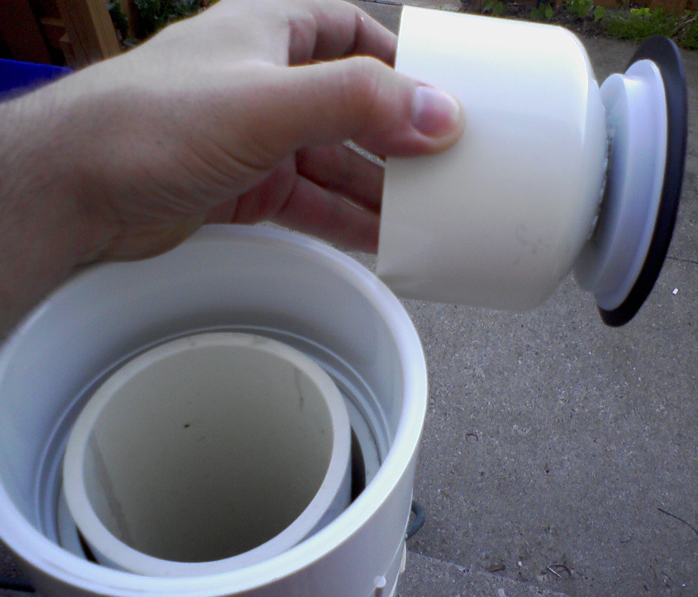

I am having a problem with my piston. When I pressurize the gun, the piston works great and holds the pressure. However when I dump air from behind the piston, the air goes backwards past the piston instead of pushing the piston back and fireing.
Anyone got a bright idea on how to seal the piston with common household supplies?

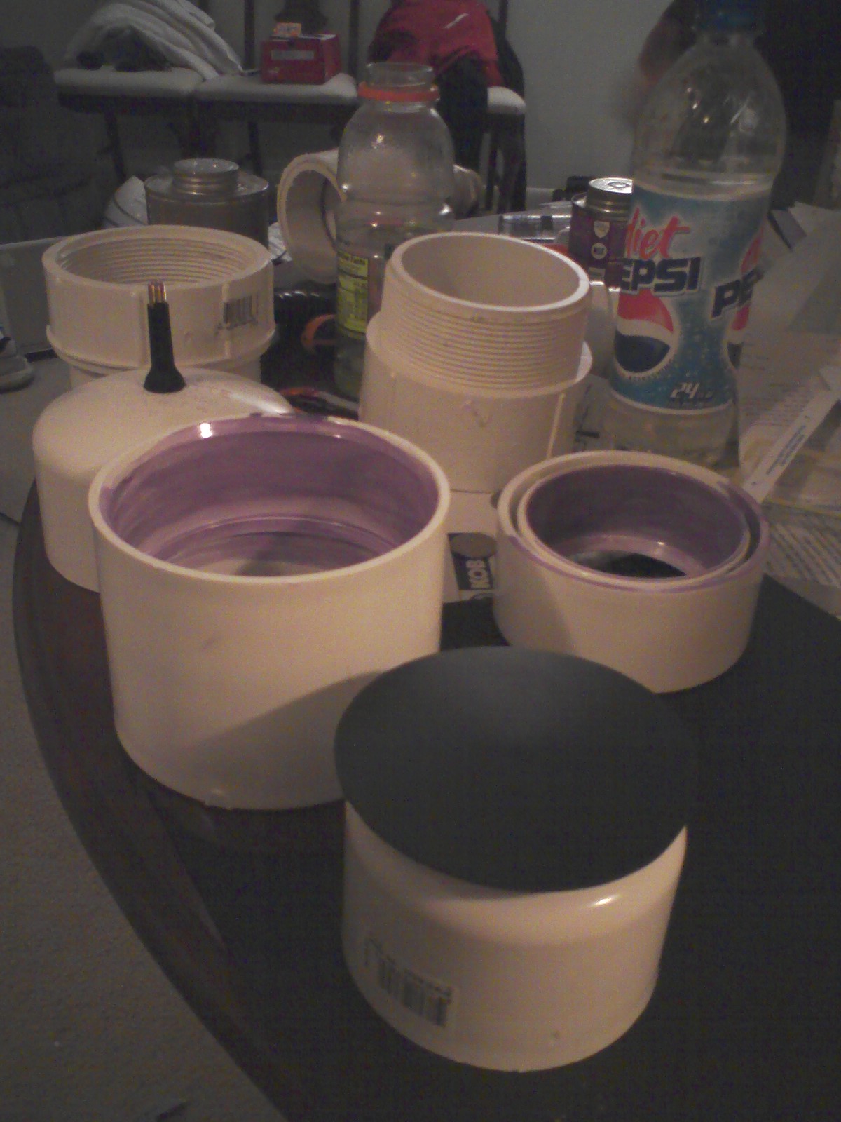

Almost done, just need to assemble the back end (3 parts to the lower left with primer applied)<br /><br />Cudos to the first person to identify the tallest bottle on the table in the background. =D

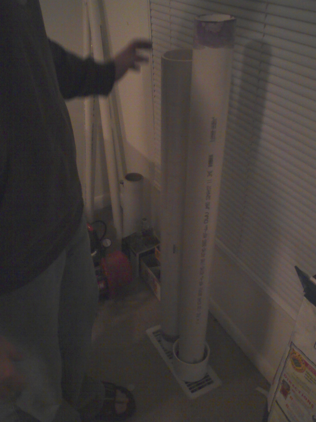

Barrel and chamber glued together.<br />Piston assembly complete.<br />(had to crop because of filesize)

Hi-Tech drying rig, and roommate.<br />The primer will be covered with fittings after final assembaly.

aren't you not supposed to let the primer dry completely. i like the gun though. are those all pressure rated pipes, i was looking at the price of 3'' pressure rated pvc and it was like 3.50 a foot. how much has this project cost

Do not glue those fittings together yet! First, add a fresh layer of wet PVC primer, and then immediately put the glue onto the still-wet primer layer. Then twist them together, hold for thirty seconds, and you are good. PVC primer should not be used when dry. Its purpose is to soften up the PVC pipe, and if it dries, it has no purpose.

Oh well I guess I learned something today, dry primer = bad.

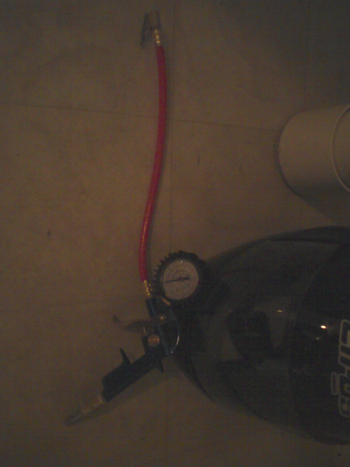

I just pressure tested it to 100psi, no leaks. I was worried about the threaded coupling, but teflon tape rocks!
Unfortunately I can't get anywhere neer enough flow to fire it, and I'm going to have to try wraping my piston (duct tape probably) to get a better seal for fireing. The neoprine held against the barrel and that's whats important.
This is the unit I am going to use for filling and triggering the QEV.<br /><br />The guage tells me current chamber pressure.
Here's what it looks like assembled, the back is barely screwed on because I just removed the piston for inspection.<br /><br />Helmet is there for size comparison.

GinsuGuy585 wrote:I'm going to have to try wraping my piston (duct tape probably) to get a better seal for fireing. The neoprine held against the barrel and that's whats important.
If you do wrap your piston in tape, make sure to lubricate it. Duct tape doesn't slide on the inside of PVC very well. But it does with some liquid teflon or lithium grease.

hi: Technically I still don't know if it will work :lol: The small chamber cross section doesn't have a good ratio to the rear (vent) cross section, so I will have to dump the air furiously to make the piston move. (QEV Power!)
Pete: I've been using veggie oil so far (great for the neoprine) it might work with the duct tape too, but will probably get real nasty after a few weeks. I've been debating graphite vs. lithium because graphite is alot easier to get, but may adversely effect the piston's seal with the barrel.
