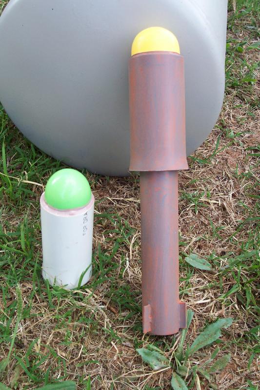

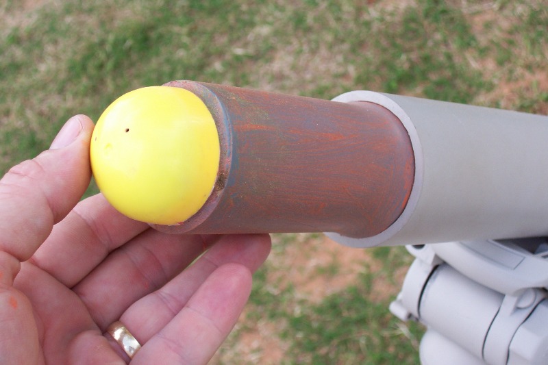

thx jimmy, the 50mm shell was well balanced to my surprise, i tried to watch it the entire flight and i never seen it tumble, it fish tailed like crazy going up and coming down. this one shot farther than my other shells due to the extra nose weight im sure. all together it has about 2 inches of bondo in the nose. im going to add about a 3 foot streamer tail for 2 reasons, 1. to get it to fly more steady and 2. to help locate the shell if it accidently goes into the tall grass. i lost one shell already. btw i have to shoot it almost straight up because it shoots so high in the air, firing it at this angle it still lands about 200 yards away with only 80 psi.

Spuddin: Cool, sounds like the round is really close to being aerodynamically stable, perhaps needs to be just a little bit longer, or have just a little more weight in the nose.
Of course, streamers will work also.

i made one of the shells longer by cementing a piece of 1" pipe inside the 1 1/2" shell and cementing 3 small stabilizing fins at the base made from a thin wall pipe cut with a drimmel.
