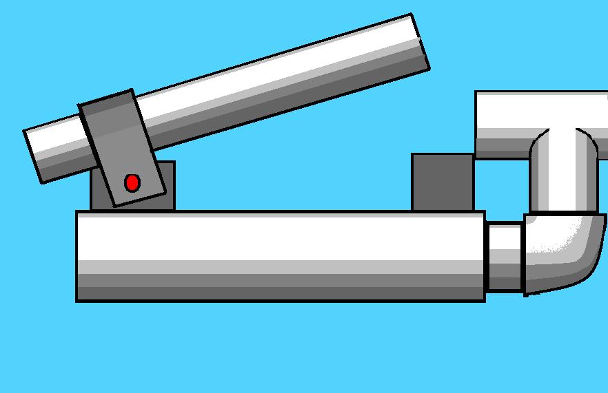

Here are the mods I propose:
The green repair coupling is foreward, but when the barrel is pushed down the angle of approach will cause the coupling to be pushed back untill the barrel is fully closed, at which point it will move forward and lock onto the barrel under the spring's pressure
Closed, the green repair coupling is pushed foreward over the barrel by the orange spring. The orange spring at the hinge is in tension and will cause the barrel to spring up when the black bolt is pulled back (moving the repair coupling back)

I experamented with something like this and couldnt get the darn thing to seal properly! but now you got you diagrams up i might go and dig it up and have another go!

ginsuguy is that design airtight because of the coupler. if it is Than i make it . Do you know good ammo fo 2in barrel i need that 2

wait do you need a coupling, do you use a coupling brian yet you say its airtight

A screw type coupler isn't needed to make it air tight but it does simplify the building and alignment.The type in the diagram will work but won't be as air tight as a screw on.
