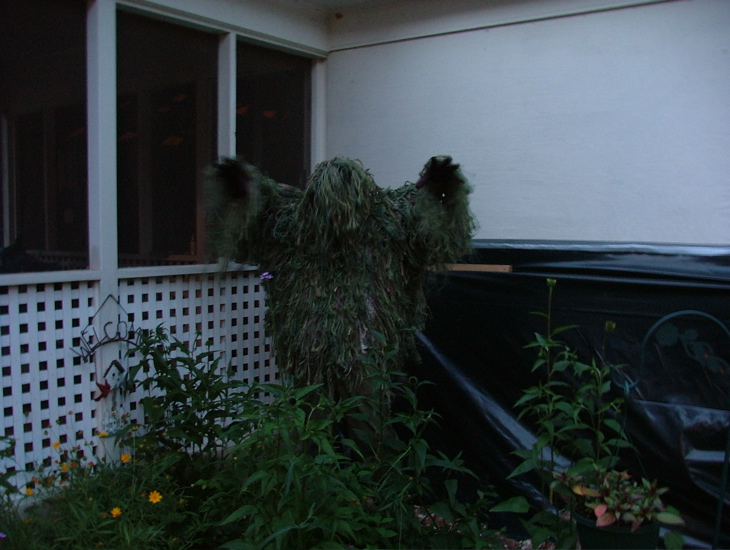

I just finished my Ghillie suit this morning and I want to show it off. My Ghillie suit only covers down to right below my waistline, and is like a poncho. I used burlap stips, jute twine, and nylon netting to make this. The reason that Ghillie suits work so well in camoflauging, is because of their 3D nature, they create real shadows and hilights. Printed camo, like on BDUs, has the shadows and hilights printed on them instead of truely creating them. They originated from when Scottish gamekeepers sewed strips of burlap to their clothing in order to acheive the effects mentioned above. These suits were also used by German snipers during WW1 and WW2, and are still in use with the military today.
Me wearing my uber cool looking Ghillie suit and holding my ICS MP5 A4 with a rifle rag wrapped around it
hiding in my suit
hiding in my suit

Wow, Thats really impressive, it works really well. In the picture of you in your garden its hard to pick you up, and if your casually strolling by you most likely wouldn't see you.

What!!! I don't see any ghillie suit?!?
Nice Job...
Looks very nice. In the second photo, I didn't read the comment and I was wondering why you included a picture of your garden.

why did you take a picture of a rose bush? just kidding, very nice.

If you make it in a poncho like style you can wear over your T-shirt, it wont get very hot. It took about 7 hours to attach all the twine to the netting. Getting the supplies ready and dyeing the twine took a while too. If you want netting cheap, try to find a local sports and fish netting company and they sell net pretty cheap. I got my 1.25" nylon netting in a 5'x9' rectangle from a local supplier for only $8! Yes, I can see out of it. I will be posting a how to on making a Ghillie hood in the How To section.
