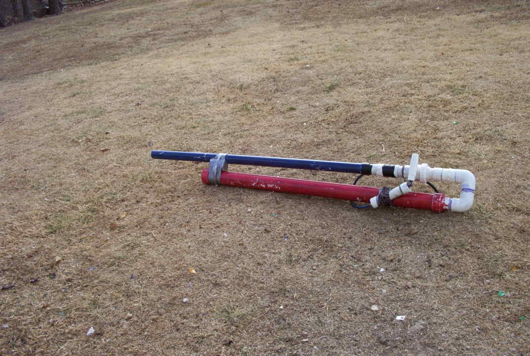

This under over type cannon,a fairly large one has an assisted valve gizmo I made from pvc,a bolt, end caps,two washers ,piece of rubber,two nuts etc.
I saw the idea for a ram on this forum a few weeks ago and thought I would try it. It is just put together in this picture with duct tape and bungee cord to see if it would work and it worked better than I expected. It will shoot great er distances than any cannon I have built so far.
power assisted valve
Since I know it willl come up I will give a little more detail on how the ram is
connected to the valve, The long bolt from the ram has a shorter bolt welded to the end at a right angle, the valve has a sturdy eye bolt threaded through the end and a nut to hold it in place the short bolt is slipped through the eye bolt with a washer on either side and a nut to hold it on. It works smoothly and doesn't snag.

awesome!!! bloody awesome!!!
but get rid of the duct tape

Nice gun! Are you going to give a paintjob? Yeah salad tosser is right get rid of the duck tape and its an amazing gun

yea you can fix any thing with duck tape it could be man's best invention
I now have a large hose clamp holding the assembly together ,but unfortunatelly the bungee cord seems necessary to allow the unit a little flex
for smooth operation, It would work without it ,but it acts like a shock absorber and so far ,about 15 or 20 shots ,it has been trouble free except for a need to oil the ram unit at least once a week..A little better paint job might be forthcoming. As shown in the picture ,it is so loud when firing ,that I lenghtened the barrel to ablorb some of the power , and that increased the distance it will shoot generously.It is still in developmejavascriptemoticon(':P')
Razznt and already looks different than the picure ,actually it lookd a lot better.
