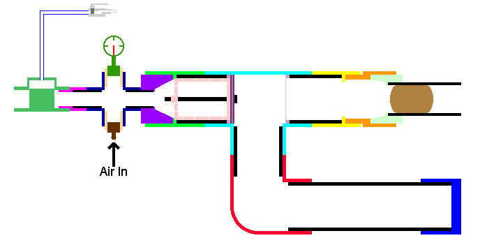

I would stick with the bushing, bell reducers (I think that's what you mean), aren't pressure rated.

So i made up a drawing with a 3" piston. thoughts?
