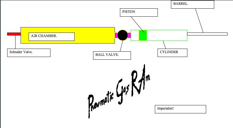

would it be possible to make one of these using a pneumatic setup i.e. have a chamber and then say a ball valve and then the piston inside a cylinder on that?
-thanks.
would this have a chance of working?

Imperialist1 wrote:would it be possible to make one of these using a pneumatic setup i.e. have a chamber and then say a ball valve and then the piston inside a cylinder on that?
Talk to Hotwired, I think he had made a prototype along these lines.

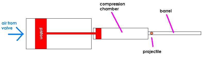

The way you drew it, you can only get as much pressure developed by the moving piston as there is behind it, so it wouldn't give better performance. What you want is a bigger piston propelling the compression piston, like so:
pneumatic powered compression diagram

if i had say a 1.5" larger chamber to a 1/4" compression chamber to a 1/8" barrel and the chamber for the air is about 2.5" by about 23".
Oh and if i went with my design from before how well would it work?
thanks.

Imperialist1 wrote:Oh and if i went with my design from before how well would it work?
It would work, but it wouldn't work better than if you just eliminated the piston and use the ball valve to feed air directly into the barrel - unless you used a burst disk behind the projectile.
