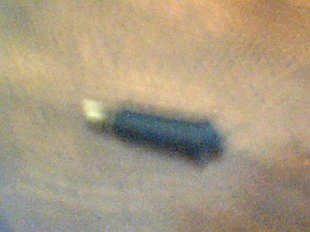

I will see if my mom will bring me to get one tonight how do you seal the schrader valve in the gun?
sorry it is blurry
sorry it is blurry

that valve isnt all there its supposed to have a big fat end
Flying_Salt
Posts: 779
Location: Texas
That valve looks like it's missing the fat rubber part that goes on the end. Auto repair shops that specialize in tires, such as pep boys should have those for sale cheaply. They're very easy to mount if you know what you're doing.
The one you can can be used, just drill a hole slightly smaller than the rubber neck and pull it though (it should be a really tight fit). It will pretty much make a seal around itself, but you can reinforce it with blue tac or something.
In simple terms:
It's sapossed to be a 11/64ths" diameter hole. Look at a new tire valve stem, theres a big thick round bottem, a grove, then a taper to a neck with a shreader valve/valve core on the inside, with threads on the outside for the cap. It gets installed from the inside out. Pull the valve stem through the hole untill the grove then stop. No sealent needed, drill a clean straight hole, litely sand off any burs/twistys.
