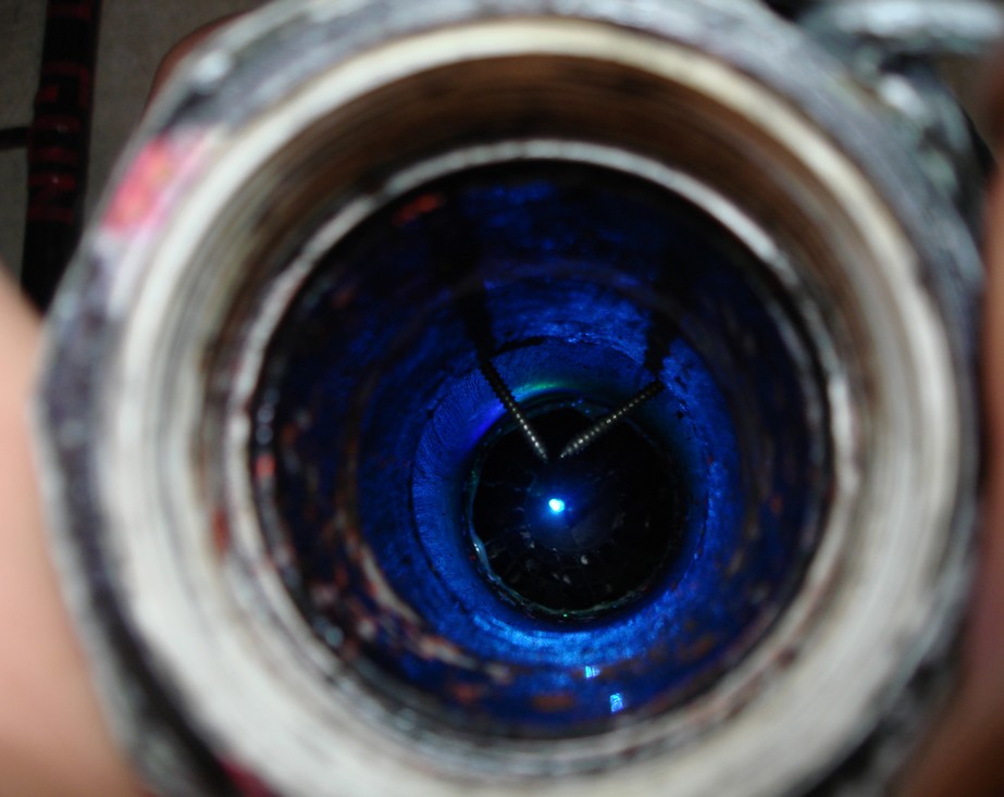

Here you cas see the inside of the chamber from the front. You can see the front contact, the color-changing LED, and the fan

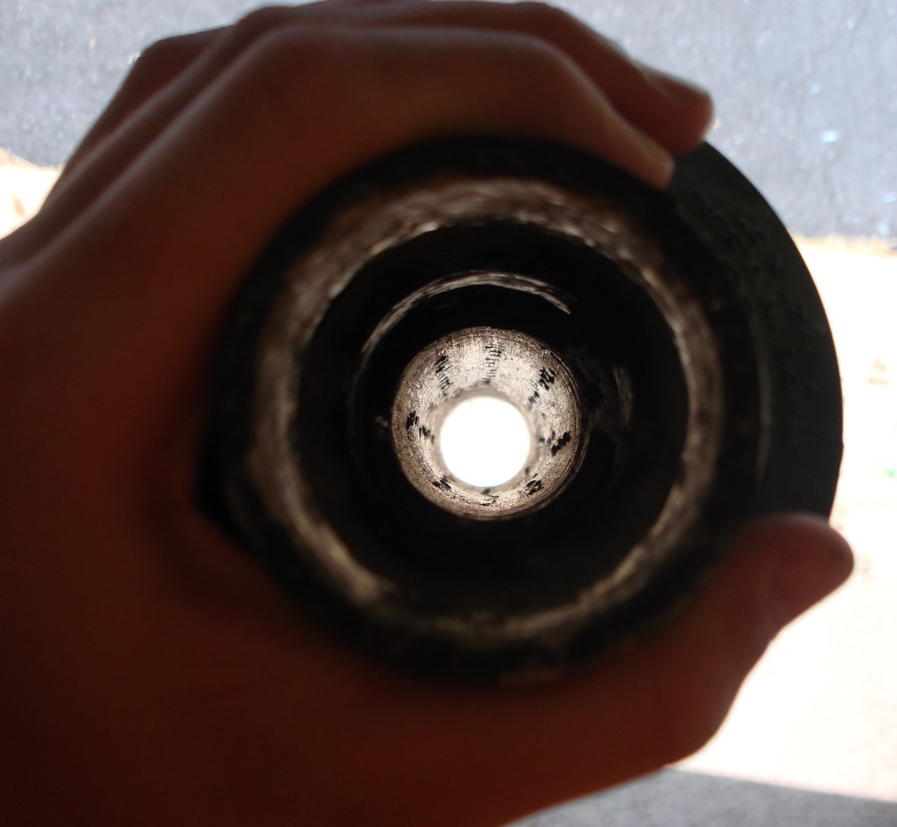

Here you can see the inside of the chamber from the back, with the lantern lighter installed. It can be removed in order to stop the small leak that all lantern lighters make. When installed, the contacts make 2 sparks instead of one. I use it as a sure-fire, just in case the grill lighter fails. Also, you can see the fan and the batteries for the LED.

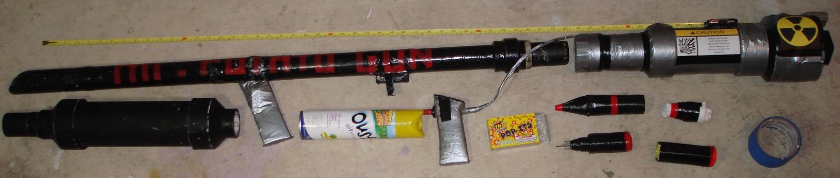

Here you can see the disassembled gun and fuel

The spudgun with all accesories. Left to right, you can see the silencer, the handle, OUST fuel, the triger, POP-ITS (for ammo), the shells (more about them above), and painter's tape (for burst disk)
