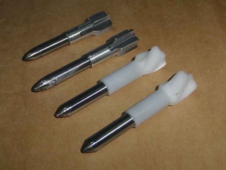

Inspired by the feedback from the first video, I'm preparing a fourth package for taofledermaus. Here's a preview of some of the rounds, all with HSS blank cores ground to a point, two of them with spiral fins in order to induce spin.
Yep, maximum diameter is just under 1/2"ramses wrote:Are those getting sabots?

How did you mill the spiral fins? Ball end mill and rotating table?
