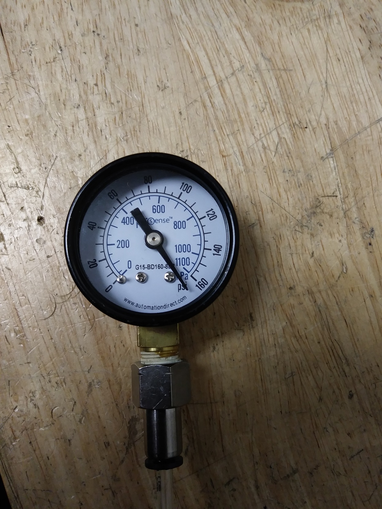

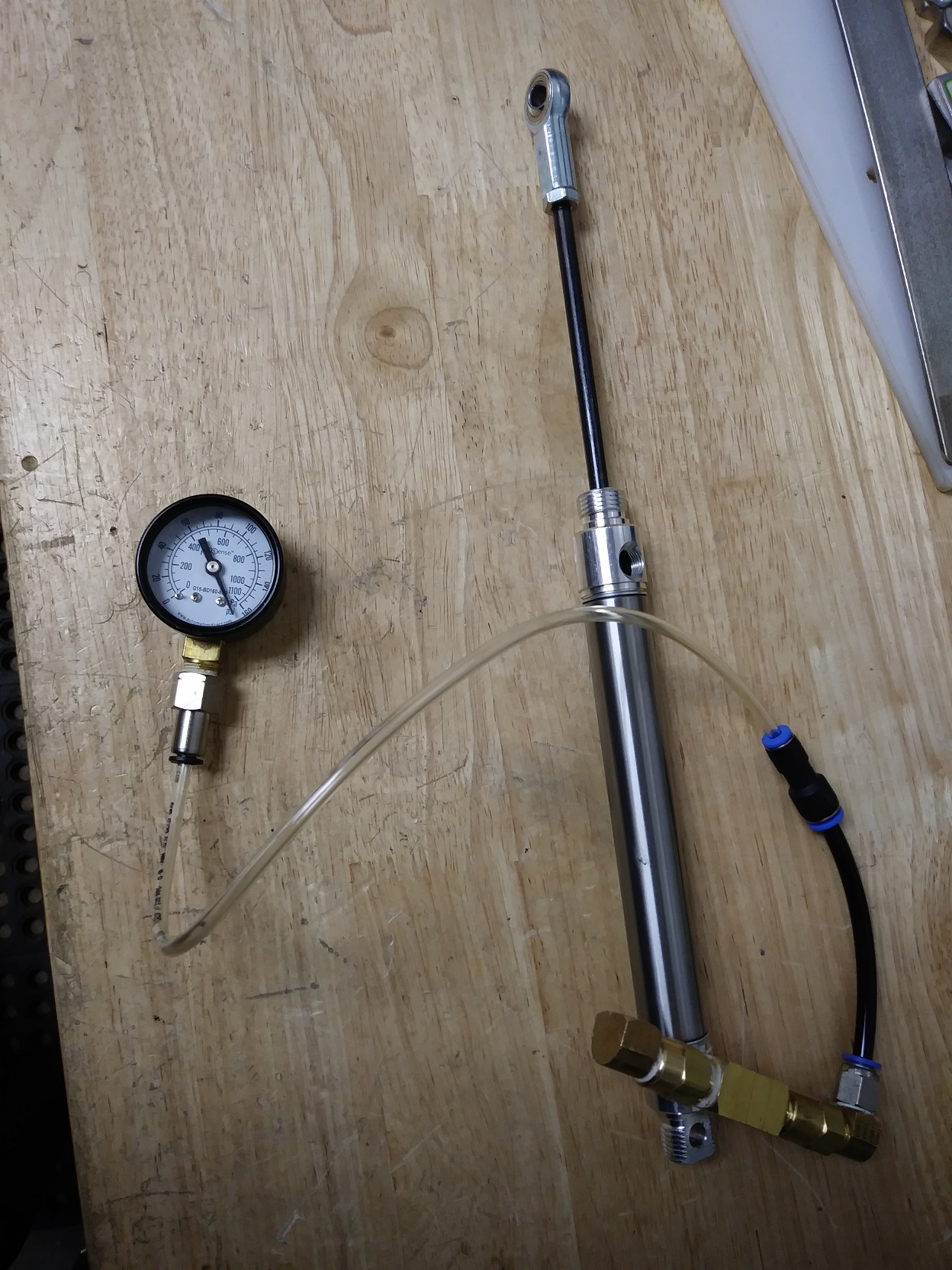

Got compact non return valves from McMaster Carr and was able to easily hand pump over 160psi with no precharge, but volume is really small, will take a long time to fill a tank of any volume.

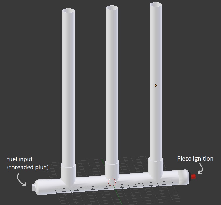

What's the best way to calculate performance for something like this in HGDT?
All three barrels are connected to the same combustion chamber and share the same ignition.
I would combine all three barrels and projectile weight into one.Cthulhu wrote:What's the best way to calculate performance for something like this in HGDT?
For example if they are 1.5 inch barrels, that's a cross-sectional area of 1.767 square inches each, for a total of 5.301 square inches each. This makes them equivalent to a single 2.598 inch diameter barrel. If your projectiles are 50 grams each, calculate for a projectile weight of 150 grams.
