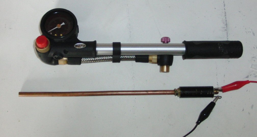

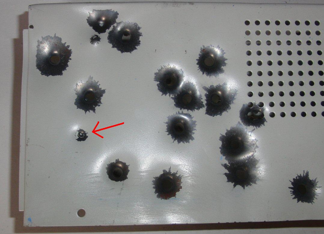

Played around with this using a less restrictive seal. It won't ignite past 17x, and at that mix number the power is rather disappointing, it left a dent but didn't go through the long suffering UPS case, hmmm...

I'd stick with the 9mL one, just use a single use suppressor, or tape some tissue paper to the suppressor muzzle. That even works on a paintball gun, but obviously isn't that practical on something that fires 17 times a second....
al-xg wrote:I'd stick with the 9mL one
The mini hybrid volume is actually 18mL, I might have gone too far on the other extreme with this one. It doesn't bode well for small sized cartridges though...
edit: maybe my expectations were too high, at 16x it will put a BB through both sides of a soup tin - not exactly weak for its size. I'll try and get some chrony data tomorrow.

for that small launcher, i think thats impressive damage

Thought about it, but the complexity of fitting a piezo ignitor in a pen sized package that probably won't be more powerful than a HPA piston pengun doesn't really seem worth it...
