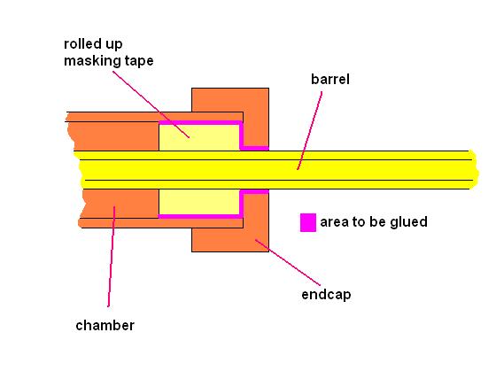

Sorry for the double post but ehhhhh I had too.. Looks like im gonna be changing the design. The barrel just didn't hold in the end cap.. There is way too much play in it and it caused the epoxy to break :( Now I'm just gonna go for an external chamber. Argh this is so bloody disappointing. I need to learn how to solder and braise :(
Least I didn't lose any parts while making this gun. Thats the only possitive I can see...
You can try making up for the play by wrapping it tightly in masking tape, or cutting a snug-fitting wooden endcap out of ply like in this thread - you'd need several discs of 1/2" ply to make sure it's up for the pressure.

No point. The barrel has slid completely out of the epoxy. But good ol' me has thought of a new idea. I'm gonna have the barrel seperate to the chamber so I can make the barrel have a bolt action breech. I used to fire these homemade darts when my bb barrel was sleeved in my marble gun. These things fly dead straight and they just keep on going. I'm not too sure how they will go at 300psi though.
