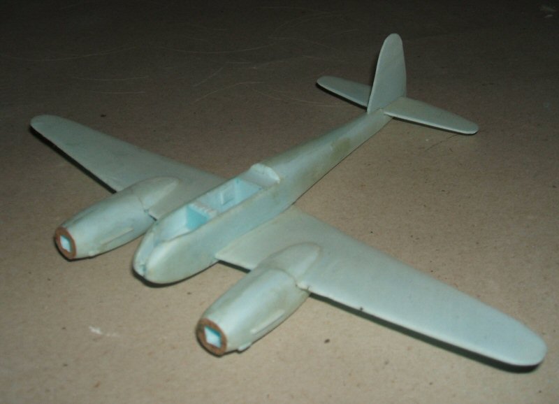

Blue foam a remarkably verastile material, here's a 1/72 scale rubber powered Messerschmitt Me 410 I had started making,a mere 9 inches span and only weighs a few grams (the fuselage and engine nacelles are hollowed out). I never got down to finishing it though as it was around the time when my interest in making holes in stuff took over everything else

Hey JSR that is one sweet plane, you never fail to amaze
Why foam and not epoxy?
one word - weight.
Indoor model planes need to be extremely lightweight in order to fly well.
