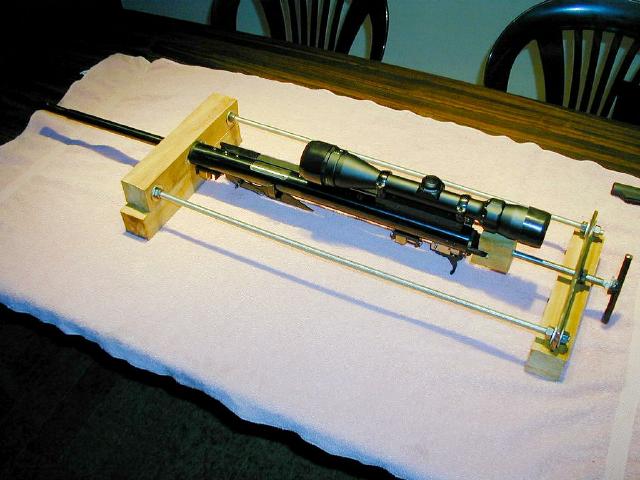

@ JSR, how would one go about removing the spring from a air rifle similar to the one in the pic in this thread?
my air rifle seem to be lacking power these days and i would like to replace the seal and spring one of these days.
thnks
chaos wrote:@ JSR, how would one go about removing the spring from a air rifle similar to the one in the pic in this thread?
Have a look at the breech seal too.
Changing the spring is a little tricky as they usually have an amount of preload, so the breech block needs to be supported with some sort of clamp in order to hold the tension while the retaining pins or bolts are removed, after which the clamp can be undone slowly, with the reverse being done to recompress the new spring.
I recently had to change the spring on my HW45 after it snapped, since the compression tube is relatively small I was able to do this with a 12" G clamp.
A rifle tends to be bigger though and may require you to make your own spring compressor, which is easily made using basic tools - there are various ways to go about this, have a look here, here and here.

ok ok, yep thanks for that i could ( if i put some time towards it) make one of those spring compressors.
the only thing i am becoming stuck on is when i get a clamp or compressor, and start to compress the spring, what actually goes down inside the cylinder and makes contact with the spring? do i need somthing else? there is a pin that i believe the spring rests on, and i know i need to knock that out, so basically do i need something that fits around the pin and pushes the spring back?
It depends on the individual model of airgun. In the case of the HW45, the pin goes through the round plug visible next to the compression tube in the first two photos (part ECP041 in this diagram) which is the part supporting the spring. Can you tell me exactly what model your rifle is, I might be able to dig up a how-to on stripping it down.

Ah, a Gamo. Don't bother with servicing, sell it and buy a proper German/British springer :D
If this is your rifle, you'd have to support the endcap (ECP002) and tap out the drift pin DP002. Contact your local dealer, he should stock spare springs and seals.
