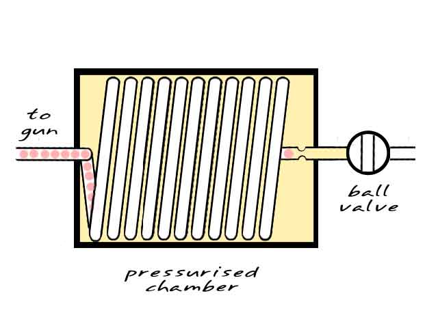

I tried searching to see if I could find details of your gun, but no luck, so I don't know 100% if this'll work for you.
The problem with a coiled tube magazine is as you've pointed out that any spring would have to be very long. Here's a way round that using air pressure.
The simplest way would be to put your coiled tubular magazine inside some PVC tubing like in the diagram below.
You use the ballvalve as a filler for your ammo, tip the whole thing vertical and pour your ammo (pink) in, then connect a pump, whatever and pressurise your magazine (yellow). Close the ball valve, and voila, the pressurised air inside the PVC tube forces the ammo forwards into your breach. You could even put this set up inside the guns chamber if you wanted it very clean looking or no doubt attach it with quick connect valves, whatever.
- pressure-mag.jpg (21.44 KiB) Viewed 4718 times
