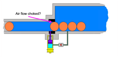

valveless marble machinegun

edit: going back the the original design, perhaps it's not even worth having a piston - maybe just having a spring loaded pin will be enough to retain the marble for enough time to give a reasonable rate of fire...

Interesting design, and a great animation.
Won't the next round severely choke the air flow into the barrel while the previous round is still in the barrel?

Fair comment, and it can't really be helped - maybe a small ramp up to the breech, so that the next round doesn't get to the locking pin unti lthere's enough pressure differential to suck it there?

I seems to me that the next round would be fired before the pin returns to the ready-to-fire-position....
I think that rounds are going to put a lot of stress on the locking pin - I suppose that the pin piston diameter has to be > than diameter of round.... becasue the force pushing the ammo is transfered the loocking pin (pressing it)...

You might even be able to use a solenoid instead of the pop off-valve, that way you could adjust the rate of fire very easily, and you wouldn't have to worry about the pop-off staying open, but installing a solenoid would be a bear...
[quote="jackssmirkingrevenge"] the locking pin quote]
Nice work here! I thought of this before but left it because my bb's have seams on ehm so that wont seal of 100%. But yeah with marbles it could work. Great animation btw. I think that piston needs lots o force to keep the marble from rolling out. 100psi = 689475.7 Pa If a marble with diameter of 1 cm is used the F on the marble is: pressure*area= 54 Newtons. Because the ball is round the force that the piston needs to have is about 76 N (if the piston hits part of the marble that is 45degrees to the barrel. So yeah I am not sure where u are ganna get this energy from. The piston is ganna need to have a diameter at least 1.5* the marble to make it work.

The pin doesn't have to support the whole force of the marble, just jam it in place, so I don't think it would need *that* much energy.
