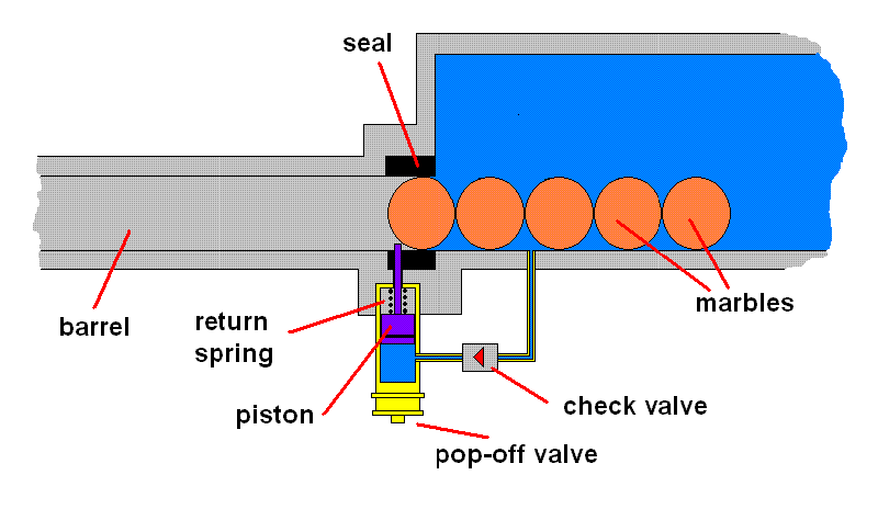

This is a combination of my ideas for a "valveless" design for hard spherical projectiles with my interpretation of this design by pvcmaster.

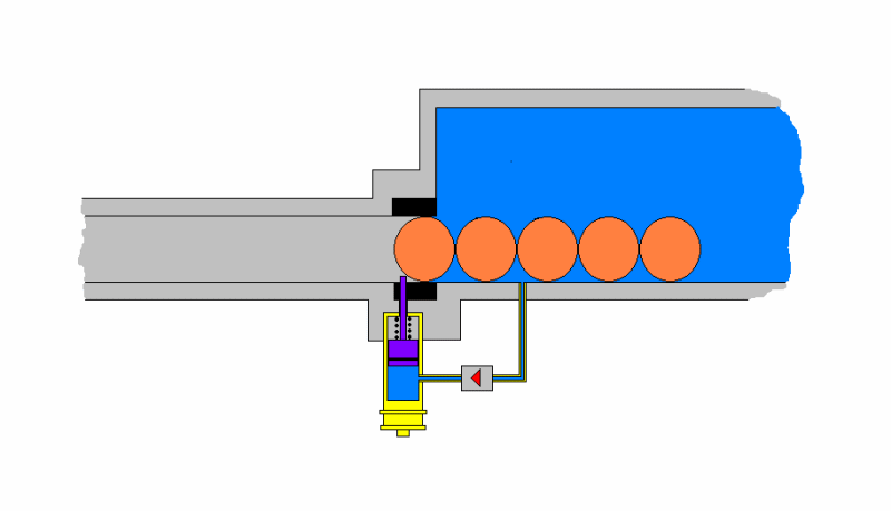

The operation is fairly obvious but I've included an animation for clarity, basically as the relief valve pops off, the piston is forced down by the return spring allowing a marble to be released. As the chamber re-pressurises the piston is forced back up, blocking the barrel and holding the next marble in place, and the cycle is continued.
The advantage of this design is that it has the performance of a burst disk valve, with instant "opening time" and no dead space, so the individual marbe energy should be quite impressive. The rate of fire could be tuned by adjusting the rate of flow to the piston chamber or the pop off valve release pressure.

cycling animation
cycling animation

"the piston is forced back up, blocking the barrel and holding the next marble in place, and the cycle is continued."
Im not sure the tiny thing holding the ammo back is enough, what pressures do you expect to use?
Look at my valvess prototype, you only need a small protrusion inside the barrel to block it off (assuming your marble is a tight fit in the barrel) - it's the ammo that provides the strength to hold the pressure, all the piston has to do is stop it from rolling forward.
This would be hooked up to a compressor so around 100 psi.

JSR that is quite simply beautiful, no dead space, no burst disc (power like one though). You don't need me to tell you your a f*&^%n gem!
I could imagine much trouble with the seals and spring (finding the right one)
but this design has so much potential it's not funny! You would have to make the "holding pin" out of some tough stuff too.To sum up i love this idea, it makes me smile inside :P
Rock on MR JSR :D
Edit: Just thought, why not have the holding pin contact the outside of the ammo seal, it would be a smoother action i think.
Bloody genius!
A few questions.
Are the marbles just going to be loose in the 'chamber' like a cloud?
You could possibly get some hop-up with the seals, yes?
If you extend the top seal further into the barrel then the bottom one, I don't see why not, considering how marbles aren't exactly the most accurate ammo, giving it some spin should sort that out.
Oh and what stops the pop-off valve from remaining open? I know on my 90psi one, even after it's below 90psi sometimes it can stay open for a bit longer.

I have the same question in regards to the ammo as MrC, I think a tube as such filled with ammo and using a piston to push the ammo down would work.
Maybe a line from the "pilot" air line to pressurise the ammo "magazine".
Interesting thought, though the trade off would be that you'd get increased wear through fatigue stress.
That's the idea
easily done
I was thinking of having some kind of flow adjustment to the piston, in practice the flow would have to be minimal given the small size of the piston chamber.

A simple way to achieve "flow adjustment" would be to plumb a schrader valve into the side of your piston housing, you very well know that if you adjust the screw valve inside said valve you can basically use it as a regulator.
It would be easier to make this on BB scale but it would be less powerful than my ball valve strafer so not worth the effort. You can also potentially use the piston to actuate a Girandoni style reloading mechanism like the one BrianTheBrain had built, meaning you wouldn't be limited to spherical projectiles. There would be leaks, of course, especially with a homemade system, but I think it would still be viable.
