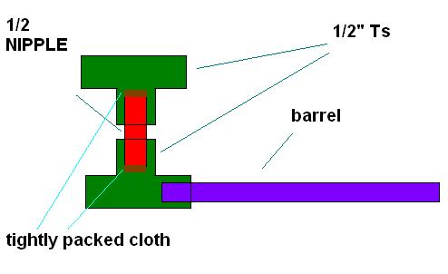

Forget about my previous silencer - I built something better
I tried something new and I must say it is really something yhmmmmm.... new....?. I included a schematic in the pic....
I threaded the muzzle of my barrel and put there 1/2" T..... then I wraped a 1/2" nipple in some kind of cloth and joined it with the T.... then I did the same on the other end of the nipple and screwed another T on top of the nipple
my new silencer works almost as good as my previous silencer build from 2X2L bottles but it is much more compact and it also serves as a crude sight...
I must say that it is rather original since it doesn't have any baffles or even expansion chamber.... it works more less in the same way like a normal pneumatic muffler..... sometime ago I had an idea that this might work but I've never acctually tried this till today....
I suppose it could be improved by adding an expansion chamber - but generally it proves that silencers built on this princliple do work
PS. sorry for not adding pics of my previous silencer but I have so much to do these days that I spend the little time I have on testng new designs and improving my gun
- newthing.JPG (14.29 KiB) Viewed 2259 times

That reminds me of a surpressor setup for a tank that JSR posted a link to a while back. Any help JSR?
You mean this one?Novacastrian wrote:That reminds me of a surpressor setup for a tank that JSR posted a link to a while back. Any help JSR?
Well if I understood correctly it's basically a muzzle brake with a packed cloth "baffle", surprised to hear it works so well to be honest.

It doesn't silence the gun completely but it makes the "BANG" at 300 psi more quiet... it is more like a normal silencer at lower pressures.....
well i think that talking about level of sound and using words like "more quiet" doesn't give you any idea about this - I have to find some way to objectively compare sound levels.....

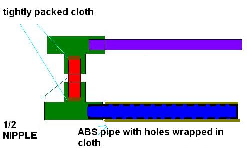

right now I am trying to determine whether it is possible to improve this... i have some idea... i think that i can improve this if i add an expansion chamber (ok it is obviuos) and increase the surface that slows down and 'leaks' the air out of the silencer
- newthing1.JPG (17.12 KiB) Viewed 2201 times
