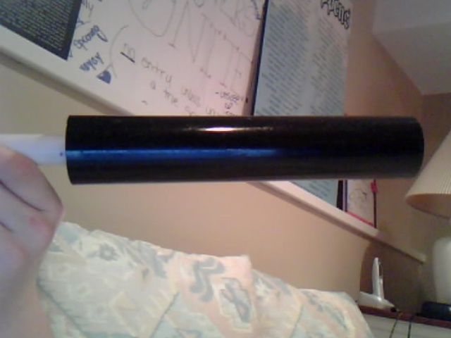

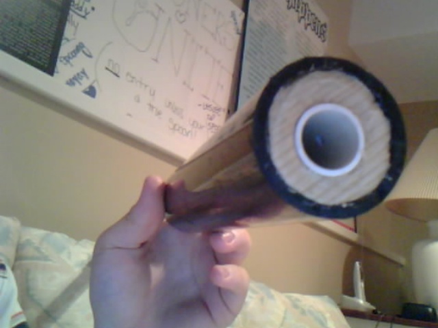

Over the past several weeks, i have built several silencers before coming to the one i have now, made of 1 1/2 abs with wooden plugs at both ends and torn paper towels as the filler. it reduces the noise from a crack and whoosh to more of a hiss and whistle
i had previously used pop bottles and paper, with varying results
I was wondering who else has made a note-worthy silencer,
What did you make it out of?
How effective is it?
How hard was it to build?
Does it look badass?
Very interested to hear what you have to say!
Here are some pictures of the silencer on just the barrel, it is a 3/4 inch pvc barrel for marbles.

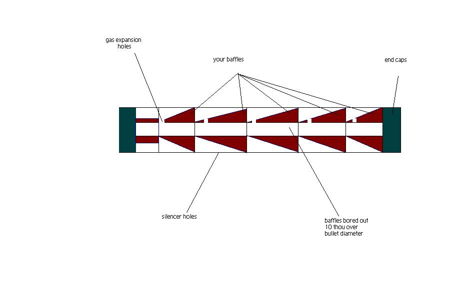

i dont know dude i would say your attempt is how you say epic fail? the way you made your fill is obscure and you should use what they call baffle stacks. now me my self i have a few silencers (store bought and 2 that i made) basicaly its a conical piece turned down on a lathe and bored out
- silencer.JPG (30.52 KiB) Viewed 7965 times

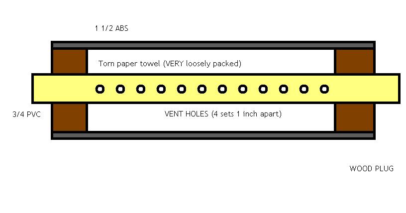

I wouldnt say epic fail, it does work. this is only one of thousands of silencer designs. i chose this one because of the simplicity of design. but i can assure you, that the sound is SIGNIFICANTLY decreased. i have added a simple diagram of the interior
The fill is actually very effective, i ripped about 3 sheets into about 1 inch squares, and then loosely packed it in, this is all thats needed to absorb the gasses from the shot. the tighter you pack it, the less effective for these relatively low power guns.
- insides, does not show loosely pached ripped paper towel
- silencer.JPG (32.73 KiB) Viewed 7959 times
