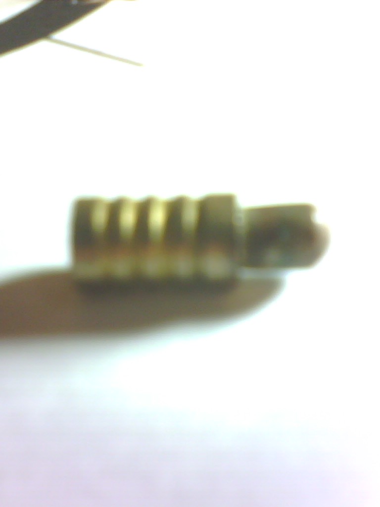

lol that is simple. could you plz send me a diagram coz i need to build one to rifle 8mm and 6mm aluminum.

sinper2006 wrote:lol that is simple. could you plz send me a diagram coz i need to build one to rifle 8mm and 6mm aluminum.
Judge is trying to sell rifled barrels. I think he's already been more than generous enough just showing pictures, asking for plans is a bit like going to Coca-Cola and asking them for their secret recipe - to borrow a phrase that someone I knew used far too much.
