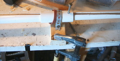

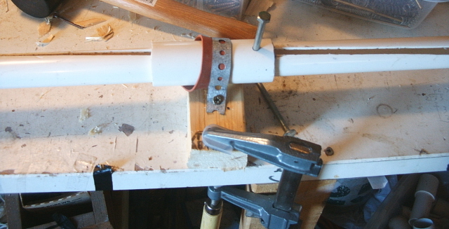

Well although it’s not a 100% success, it does indeed work.
It consists of:

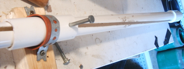

A piece of 1 inch PVC pipe as a die (note: die is not the appropriate word I just can’t recall the right term at the moment.)
A short piece of 1 ¼ inch pipe with a bolt in it as a barring/guide block
A piece of wood with a channel cut through it for part of a barrel clamp. (Originally used to keep the strap from biting in to the “good” wood on a pallet of lumber.)
A few short lengths of perforated strapping, used as clamps for the barrel and guide block, didn’t work.

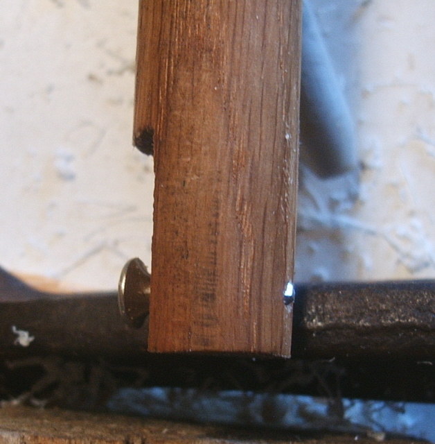

¾ inch oak dowel for a cutter rod.
Part of a screw for a cutter.

Then came the cutter head, my first thought was to bend something up from metal strapping I got as far as trying to figure out how to attach it to the cutting rod, may plan being to use a small screw, the only problem was how to keep the screw from scratching the bore… “Oh, hay, I could just forget the sheet metal thing and use the screw!”.

Anyway, the only problem is the clamps won’t hold the barrel or the guide block, but other than that it works.
How it works:
First you clam in the barrel, then you adjust the screw to were it’ll just barely cut and then push the cutter rod in. the cutter rod rotates with the die, which has the blank of the rifling cut in it.
Run the cutter rod though the barrel till it stops cutting, then turn the screw in just a tad.
Continue till the grove reaches the desired depth then unclamp the barrel and rotate it 90* and start the process over.
You do that 4 times and viola you got your self a rifled barrel.

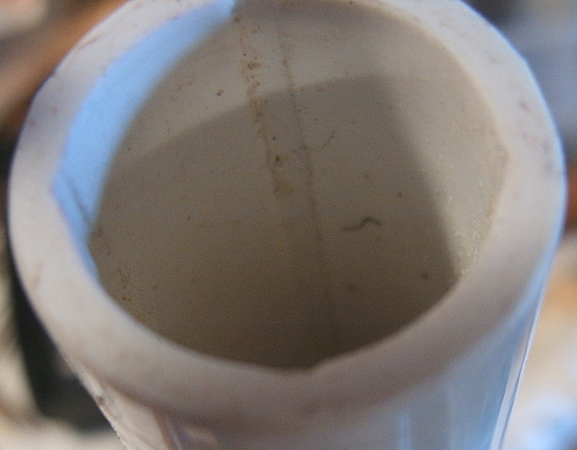

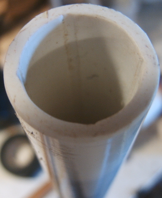

can we get a down the barrel pic to see the rifling? looks like a good design though, how deep are the grooves?

ALIHISGREAT, unfortunately none of the down-the-bore pictures came out.
And the groves can be as deep or shallow as needed, I think I could cut all the way through.
