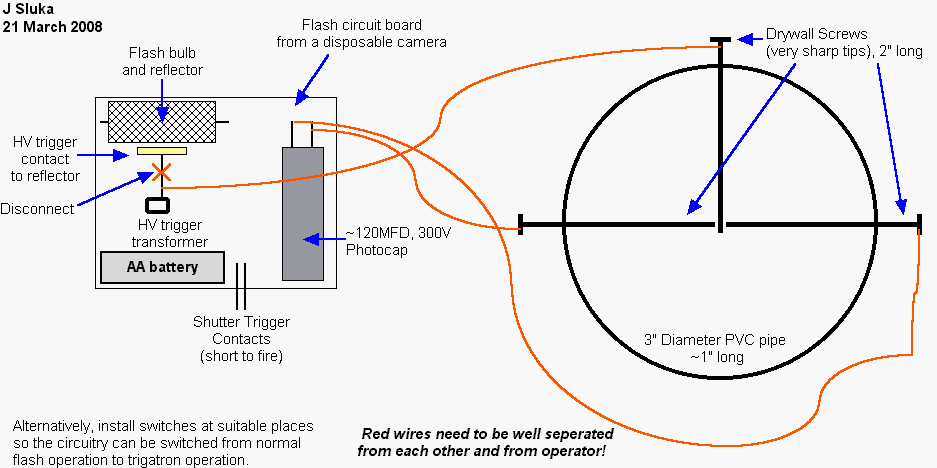

What you are trying to do is get a "trigatron" to work. That is the tricky part. Your high voltage/power setup looks good. It is getting it to trigger that is hard. Generic switches will be melted into a blob of plastic and metal when used with the kind of power you are working with. The solution is the trigatron switch.
Take a look at the link turbospider posted
http://www.angelfire.com/80s/sixmhz/camera.html
or this one
http://www.angelfire.com/80s/sixmhz/trigatron.html
The spark gap setup should look like this one from sixmhz pages;
If you are just getting a wimpy spark then only the high voltage (couple KV) is actually sparking. The high voltage comes from the second transformer on your photoflash circuit board and it is the lead that was connected to the metal reflector around the flash tube.
You need to get the other two elctrodes closer to the HV electrode so that the small spark from the HV allows the much lower voltage (~300V), but much much higher power, from the photocap(s) to be discharged across the gap.
Got to get everything pretty close together. Pointy electrodes will help somewhat.
Once you get the spark gaps to work they'll tend to burn themselves up after a few uses so you might want to build it so thngs are adjustable.
Here is how I did it for a single photoflash board as a demonstrator. If you use fine thread drywall screws you can just screw them in as they burn up. Drywall screws have very sharp points, but they tend to get melted pretty quick. Make you connections to the screws with aligator clips and you can just replace the screws when they get to toasted.
- photoflash_banger.gif (16.25 KiB) Viewed 4129 times
