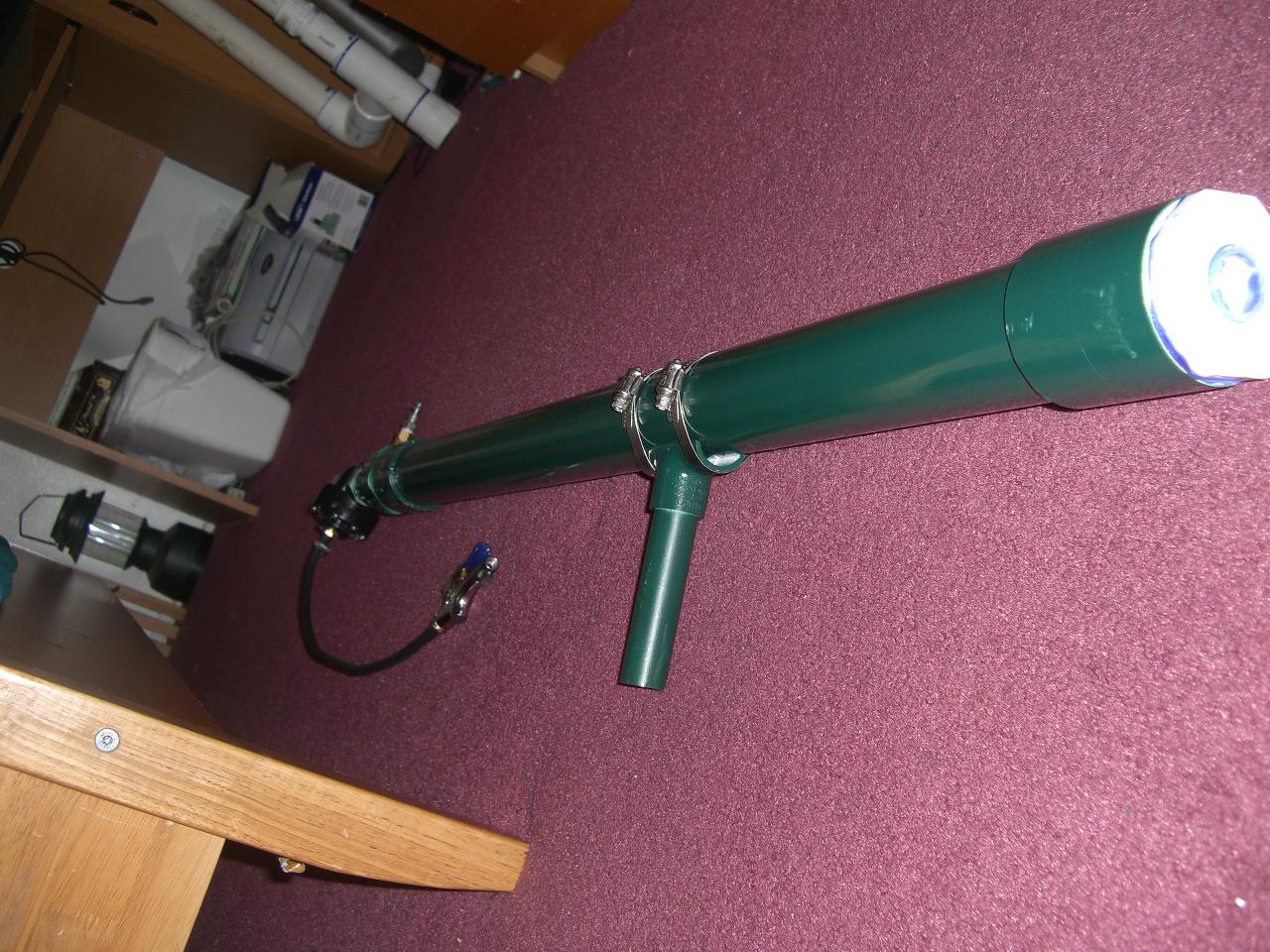

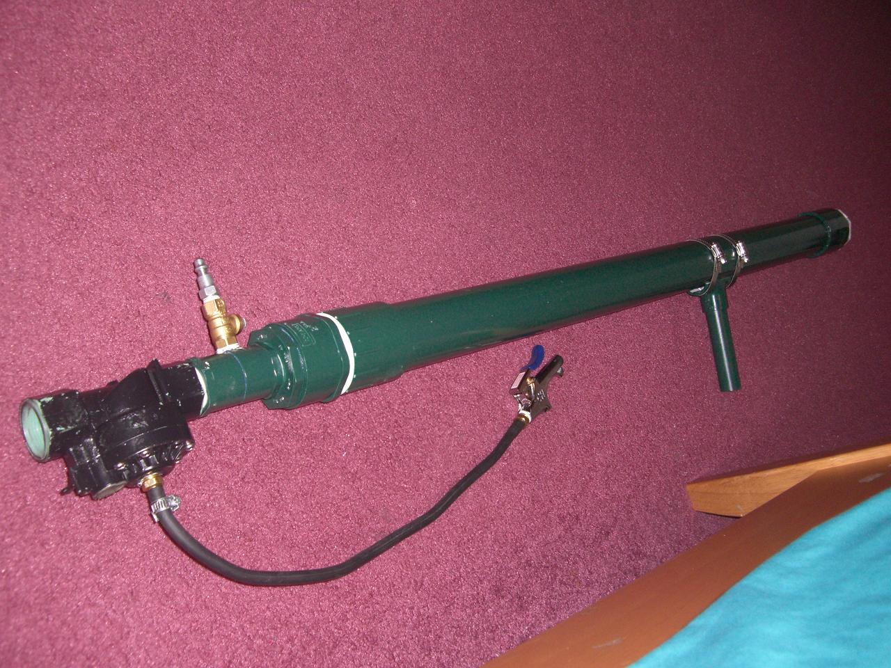

This is my first coax, and third piston valve. all together its 1.1meter long the barrel is sch 40 3/4'' chamber is 2'', pilot is a 1'' sprinkler, fill is a qc, ammo is 8g-12g, co2 missles. i painted it hunter green, piston is 1.25 endcap. hope you guys like.

the paint job is nice, and make sure that your sprinkler valve doesnt take a crap on you, mine did so i had to replace the sprinkler valve with a 3/4 inch ball valve.

ha thanks, yea my sprinkler valve occasionally sucks in the bumper
witch is annoying. I too canot wait to see your gun i know its guna be awsome.

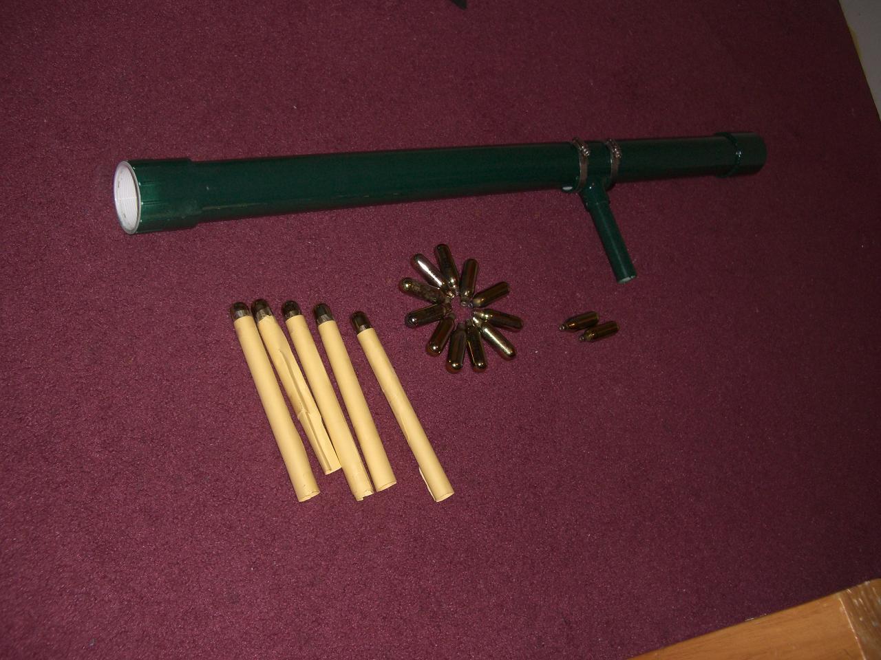

They look like co2 cartridges with paper tube tails,if I'm correct.Nice gun i love the bazooka look.

yeah there yellow paper tubes
, thanks but i would have thought people would have said it looks a little to skinny for an anti-tank launcher since its only 2'' pipe,I though it would need like a 3'' tube to make it look authentic but eh, i dont have that kind of pipe available to me to me
