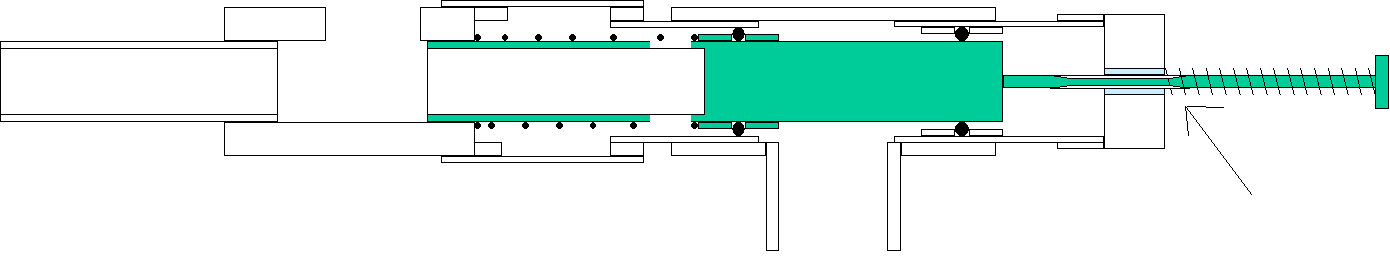

its very different from that, that is for the ion, it's only semi automatic unless the pilot valve is electrically triggered rapidly, that is designed to be a simple piston valve bolt comb that can use a 3way valve. the green is the pilot in the animation but in mine that is an air spring
@ant: yes it could be smaller but with larger volume the tension of the air spring doesn't exponentially increase as fast, and their is only one schrader, that schrader is there for manual filling in case I later want to detach the feed or mess up on the pressure reducer I can instead do it manually, and if the pressure goes down you see the pressure reducer lacks any method of venting so I can just poke the schrader
@jack maybe so, but I can always just choose a higher pressure difference, 20psi should be fine right, btw thanks for the animation
but do you think it could be safe enough for a sealing face instead of the larger plug :idea: I just got an idea
EDIT: thought of a little revision stuff so I altered the diagram
auot bf bolt 2.0.PNG (15.36 KiB) Viewed 2847 times

solinoid? why? its not like the ion, it can work with a simple open/close 2way valve which is so much simpeler

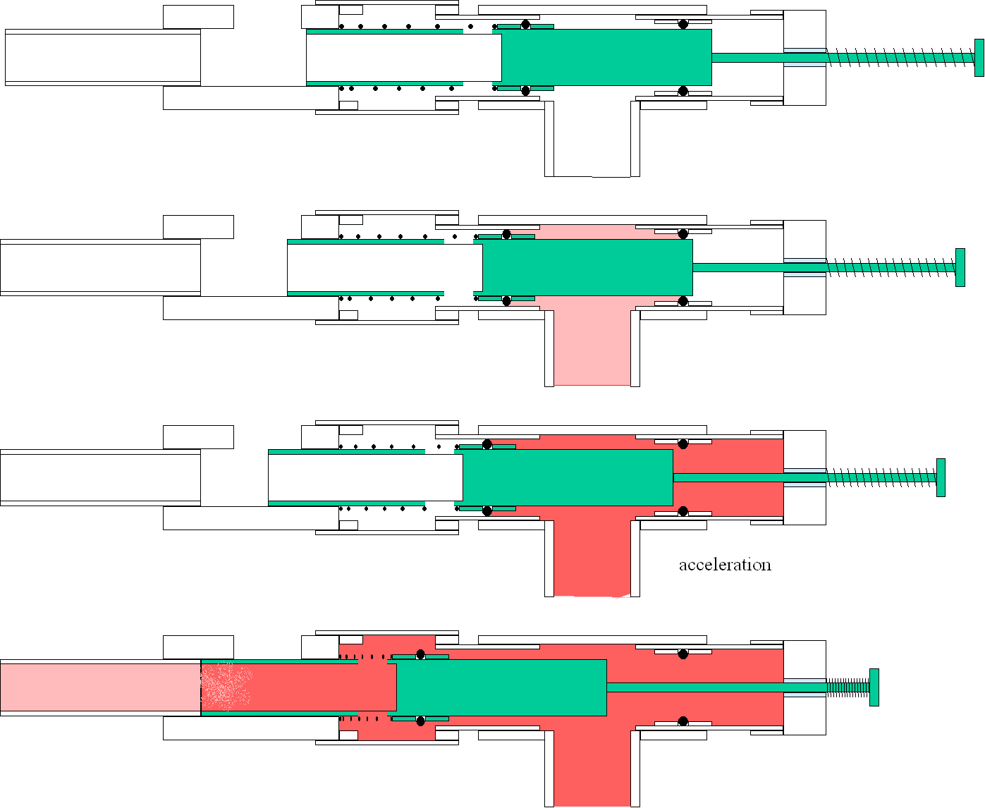

Oh I get it now. When it fires the pressure in the fining chamber drops to the point where the air spring can return the bolt to its original position. Then the cycle repeats. What I don't get is how the check valve lowers the input pressure.
Overall, looks good!

yeah I think you got it, the check valve in this has a high tension on the spring, the force of the spring cancels out some of the presure, think of it this way on one side it has the force from the input presure on the other side it has the force of the spring and the holding presure to push it closed, so the spring helps the thing close without a presure equalibrium thats about as best as I can explain it for now

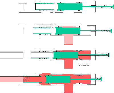

no I have a fully automatic version in the format of blowforward bolt/piston that has a semiautomatic equivalent in the ion's design, it's not piloted, ion based designs are like this
ion and direct ion derived designs=one bang per a pilot acuation
my design= air goes in and full rapid fire
anyways the other design posted hear just reminded me of another possible way to make a full auto

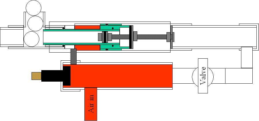

v 3.0
v 3.0

/Edit. Ok i see how you are reseting the Bolt...
But where is the Air that Resets the bolt going to go? If the pressure is equal to whats behind the bolt it isnt going to move.

socoj2 wrote:/Edit. Ok i see how you are reseting the Bolt...
But where is the Air that Resets the bolt going to go? If the pressure is equal to whats behind the bolt it isn"t going to move.
your talking about the last diagram right, well the hope is that after the pressure is dumped during the shot the springs will reset the bolt before much pressure can get behind the thing, :idea: or I could narrow the base of the rod on the back so that pressure will bleed off when fully reset
arrow pointing at the change I made
bf auto 3.1.PNG (13.07 KiB) Viewed 2777 times

okay sorry about the double post but I really need some advice on choosing a design, the most recent does allow for larger surface areas than the bolt's max surface area so the should have more power right?
the other ones are fairly simply and may be easier to make using the air spring, and the one with the sealing face, its kinda inaccurate with the diameter in the diagram, but the spring tension won't slow the acceleration as much due to pressure drop on both side being dumped
I'm not sure which to try building
