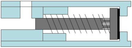

so back in spudfiles contest of 2007 clide came out of nowhere with his fully automactic HEAR valve after brain storming through designs for valve, the thought when around for piston valve like the hear that would act as a valve and a bolt. one day while explaining to one user why his design for a blowforward bolt/piston valve would not hold the piston/bolt back due to the lack of cross sectional area in the pilot, I was inspired and modified the design into a fully-automatic-piston-valve/blow-forward bolt original thread . Recently I have revisited the design and modified it yet again so that it is semi automatic or fully automatic, what do you guys think

hmmm it doesn't function as a 3 way valve... that can be fixed easily

the valve does not cut it's own air supply when it firesit doesn't function as a 3 way valve
I abhor this obsession with complicating things

do you have a fully/semi automatic bolt/valve design that's simpler?
it's not that complicated it's an integrated bolt and a piston valve all in one an auto piston and a blowforward bolt may be easier to understand but the parts are not integrated there are more parts, in this there is only one moving part that obtains full auto,
originally I wanted to use a spring so there would only be 3 seals like the hear valve, but I doubted I could get a strong enough spring so I went with an air spring and a simple check valve with a tight spring would automatically adjust the reduce the pressure so the gun could operate at any presure without adjustment. now I realized I could do semi auto with a valve attached to the airspring
I challenge you to design a simpler one with as much or more function
edit: does this design suit your tastes sir, and btw arn't you working on a computer controlled sentry

I am afraid this won't work... first of all becasue the bolt won't return to its original position (it could if there was a vent hole but that wouln't make sense)
secondly, you need to cut off HPA in a balanced or almost balanced way

I'm not using HPA, it's under 100psi, in terms of piston valves the red area acts as the pilot, which do you think will pressurize first the tiny red volume or the big chamber volume, you don't need to completly cut off flow to the chammber because the pressurization is much slower, how do you think you fill a sprinkler valve gun? air connected to the chamber doesn't mean that the piston can't reset

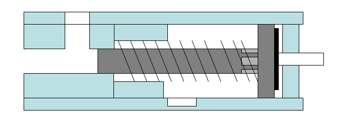

I was referring to the one in the second pic...
anyway I also think that simplicity is important...
but the only question is how far you should go in simplifying stuff
you know, the unicycle is simpler than the bicycle but for some reason the latter seems to be more popular
here if the air source is not cut off you lose air... fixing that does not increase complexity up to a point where it would cost to much, weight too much or would decrease reliability

actuly the second picture operates on the auto valve design, the sudden exposure to a greater surface area make the piston move fast into the open position then the drop in pressure is more than enough for the spring to handle, an additional chamber and flow regulator also works

Yes, this might be worth trying, I've edited you diagram somewhat:

Aren't you working on a computer controlled sentry
Well yes, but in the least complicated manner possible

really, but then it doesn't take nearly as much advantage of the increased surface area to create a rapid opening. while this may work better for you in practice most likely because of the increase in counter-acting mechanical pressure as the spring is compressed further, once addressed it can be made more effective by increasing the weight of the piston so it will hold open longer thus close with a lower pressure. what I wish to say is that you shouldn't completely forget the idea of an un-exposed auto piston because otherwise there is not enough movement in the piston to cycle the bolt. theoretically it should be possible although it may work best with larger systems where proportionally the input flow is less, which is what this design is for, I specifically designed it so it could be made with pvc pipe.As I was discussing with Brian recently, the critical element is that the porting is exposed when the piston is at rest, in short:
It has to be that way, or else face resetting problems.
- POLAND_SPUD
- Posts: 5402
JSr but what kind of flow coef can you get with it ? and where's efficiency in it??

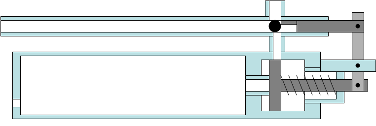

and normally that would be due to the pressure from the input or chamber being still relatively high, but with a larger volume chamber and system with a relatively slower input it could workpsycix wrote:It has to be that way, or else face resetting problems.
perhaps this might work since it has a larger chamber volume and some volume around the seat for left over pressure (maybe a one way sealing floating o-ring design around the piston might help also) and it utilizes only a small distance for piston movement
