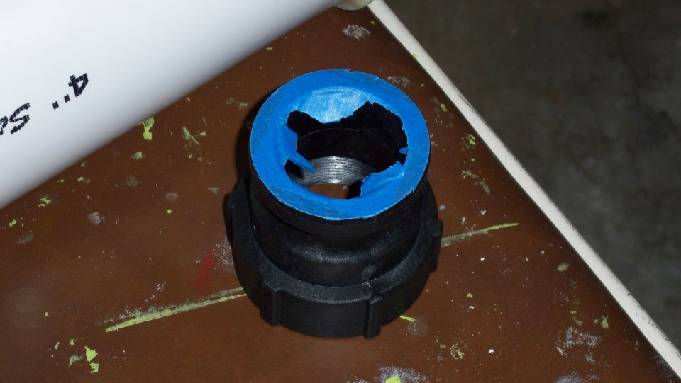

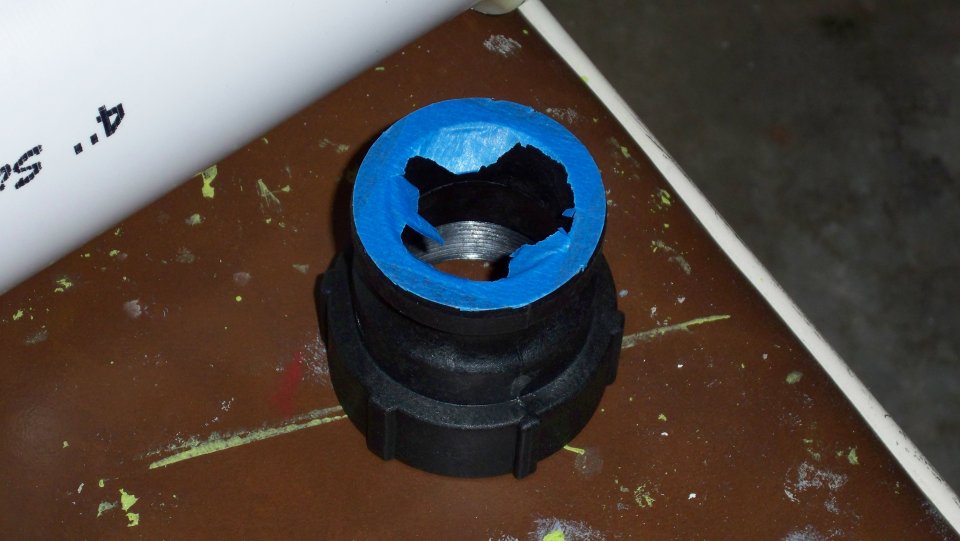

Being a combustion leaning guy myself, I would like to throw my hat in your ring to say ....go big combustion. I want to challenge the notion that a pneumatic design will automatically offer you a more powerful big-bore spud cannon, assuming that's what you're looking for of course. Pneumatics will ultimately win against a burst-disked 1x combustion but you'll have to use big airtank, a lightening fast piston, and large psi to do it.

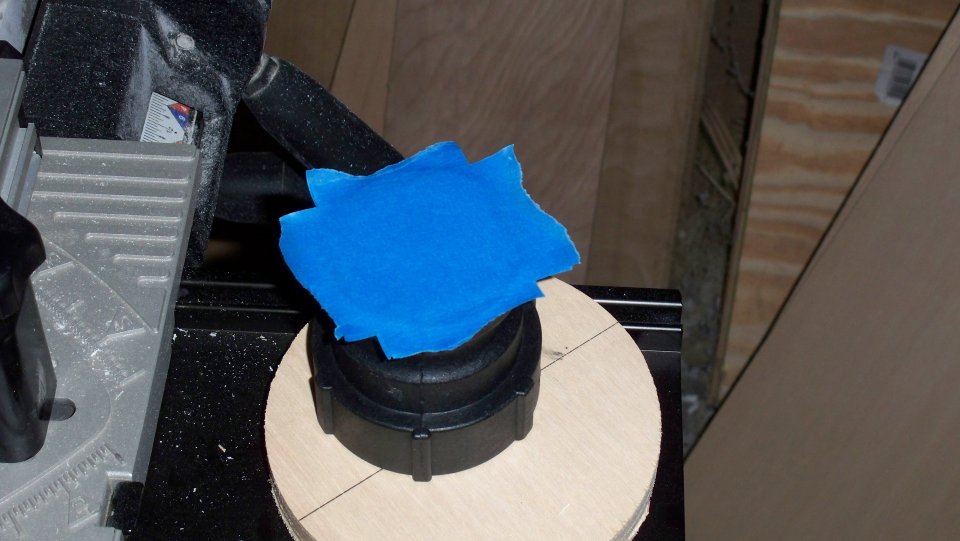

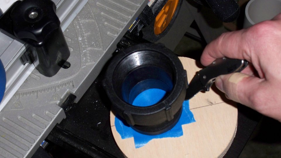

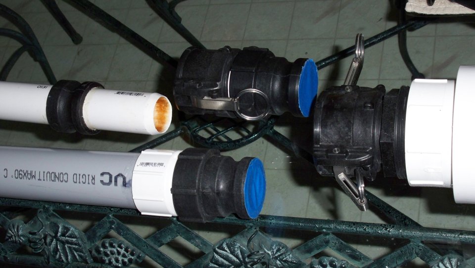

A feature almost totally ignored on 1x combustions is the simple addition of a burst disk union or camlock burst disk option. I have been getting noticable power and speed increases using the burst disk below. These burst around 80 psi and offer amazing results over a humble standard advanced combustion.
Even using a modest 30 psi disk will show a noticable performance improvement. I'm using the male camlock plugs shown below as a barrel stump by itself to use in my noise cannons I'm building.
With that big chunk of 6" pipe you have, you could build a whole fleet of big combustion chambers.
