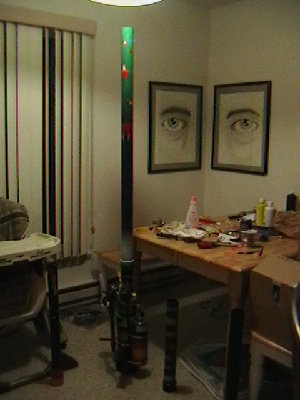

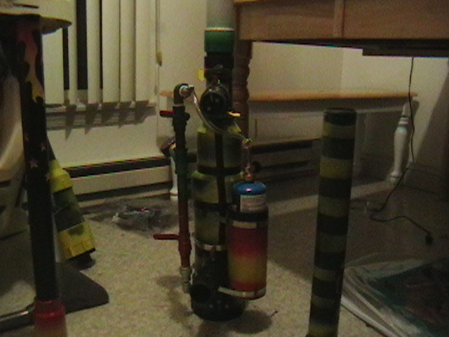

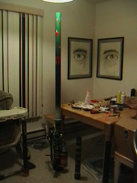

Ive completed my transition to metered propane, and have put a good little bit of work/money into making it right. I still have to measure my chamber volume again, as well as my measuring system. Also the meter attached is crappy, and i have a new one I'm gonna put on, but i misplaced the tools i need to disassemble the components. I have tested the propane system underwater with no leaks first try at 90psi, so I shouldn't have to fill it too many times to get a good 4% in the chamber. I HAVE NOT shot it yet, and i will post about it whenever I do... here is some pics of the new build.

Looks like quite an upgrade.

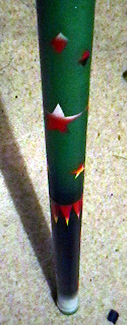

I would like to see a better shot of the paint on the barrel.
You mentioned: "... the black down the middle is electrical tape to hide the fan wires... gonna do something about that..."
The coolest wiring I (found) was off a payphone cord But unfortunately I threw it out cleaning up. something similar, but bigger, would be MC (metal clad) or BX wire for electrical (electrician stuff). Or the plastic stuff used on speaker wire.
Nice job 8)
Nice job 8)
- daxspudder
- Posts: 300
- Joined: Thu Apr 24, 2008 10:22 pm
The wires are double insulated, once by their own, and again together inside another sleeve, the tape just keeps them flush to the cannon. If you want to see a better shot of the barrel this is the best i have at the moment, waiting for batteries for my good camera to come in the mail...

I decided to take some volume measurements on the new barrels against the chamber, I have some really good news, the 4'x2" barrel. With a chamber volume of 294.34ci a 3.93'x2" barrel makes a perfect .8:1 C:B ratio. Now I just have to wait for payday to gas up my explorer and head out to my range, had a fight with the neighbors and my backyard is out of the question for a little while. But I have alternatives. Oh I have batteries for my better camera, so I should have some high quality pics sometime soon. Not sure, but this might be a double or triple post, but its relevant, so again, if it bothers you, you have my apologies.

You're making some good headway on the metered propane, that's a good thing! Your meter looks big enough to require only a modest pressure, maybe 40-50 psi, to get 4%. Don't take my word for that though, do your volume calculations and get it right.
40-60 psi meter pressure is good for colder weather shooting when the pressure from the propane tank drops noticably.

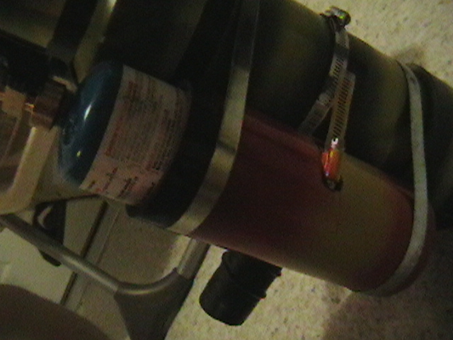

Well I did the math on the meter volume, and I only need 6.5psi for exactly 4%, as the volume of the meter is 9% of the total chamber volume... I have never seen a low psi meter, does anyone know where to get one, like one that goes 0-20psi? both of the ones I have go over 120... which means 5-10psi will be pretty hard to measure accurately... a Little help please...

I agree 6.5 psi sounds way too low for the meter you show in the pic. Is that 1/2" pipe and ball valves you have there? Measure the actual inside diameter of the pipe, it will be much greater than 1/2" (is actually the 3/8" pipe ID). Be sure you are using the radius and not the diameter in your calculations.
FWIW...pi*radius*radius*length = cubic whatevers
No way that meter is 39 cubic inches. Give it another look.daxspudder wrote:meter is 39.25ci, chamber is 237.07, 4% of 237.07 is 9.48ci.

Good call. Thank you, I definitely just took new measurements the right way and the meter is more like 4.5ci, so 25-30psi will do the trick nicely, thanks starman, oh and my meter will work at those pressures nicely.
