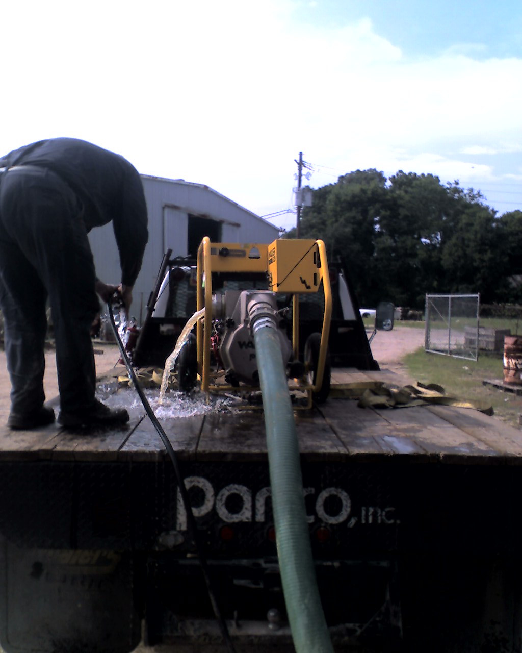

Anyway, the dredge failed miserably. The desing my supervisor wanted to use was a cheap (and ineffective) venturi jet design. The picture is included below. I knew that this design would be very inefficient, but I really didnt think that I would be a total flop. In order for it to have a bette chance of working, the pressure inlet should've been necked down to 2" and the suction inlet to 2" which would meet in the 4" WYE. Or I guess the suction and pressure inlets could stay 4", but exhaust into an 6-8" pipe. Regardless, an inefficient design.
What they ended up doing was using the discharge from the pump as a pressure washer of sorts. Using the flow of the canal, they were able to blast a 2-3' deep, 6-8' wide, 150 yard long trench. Not too bad for 8 hours.
Now I'll begin work on building a proper venturi jet (pictured below) in preparation for post duck season.
Also pictured is the pump. That sucker emptied a 55gal drum in seconds. Simply a beast.
