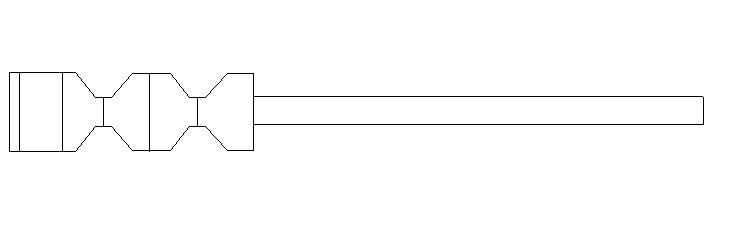

I'm in the process of gathering info/parts for a 2.5" cannon for tennis balls. I've got a friend that has a cannon that he uses to shoot golf balls. In the past, he had a 4" chamber (roughly 20" long) and got good distance using an aerosol propellant (Tag body spray). Now, he uses a venturi shaped chamber design and gets a lot more distance (around 1800 feet). He uses a lantern spark igniter in the cap of a cleanout.
Have any of you guys tried this chamber design using direct propane injection?
Rough look at the chamber design is attached. I'm estimating that the chamber is 2 feet in total length and the 1.5" sdr 21 barrel is 45" in length.
Thanks for your help.

So this would increase turbulence and therefore there would be more fuel ignited? its the only way i can see it working...
My understanding of the venturi effect was that it increased the speed of a fluid.. but decreases the pressure...

ALIHISGREAT wrote:So this would increase turbulence and therefore there would be more fuel ignited? its the only way i can see it working...
I guess it's behaving as a fan during combustion (mixing air and fuel). I have witnessed the extra power though. It's guess it's also likely that the decreased volume from using reducing couplers (instead of a straight 4" chamber) also helped increase the pressure?
For the purposes of building my 2.5" gun, if I get my C:B ratio right, there's really no reason to go with the venturi chamber design. I don't plan on using a fan at first, but may add one later.

While it would increase the surface area (therefore losing performance to heat loss), the first funnel would create a high(er) speed jet of burning fuel through the gun, as well as igniting the side branches on it's path. This would perhaps eliminate the need for multiple ignition points and a fan.
I don't think you're getting the full benefit of the venturi effect at the barrel in that picture, because you're suddenly blocking the air's passage. Either make the barrel the same size as the chamber, or make it a conical shape leading to the barrel (like a bell reducer).

Biopyro wrote:While it would increase the surface area (therefore losing performance to heat loss), the first funnel would create a high(er) speed jet of burning fuel through the gun, as well as igniting the side branches on it's path. This would perhaps eliminate the need for multiple ignition points and a fan.
He actually has a 4" x 2" reducer coupling at the end of the chamber, I just left it out by accident. I want to use propane injection, but don't want to deal with fans and electronic ignition. I might decide to roll with this venturi idea afterall.

As far as my input on the actual topic, interesting idea. Its not the first time I've seen it though. Others claim to have "multiple chambers" when its two chambers in series, but not far off from what you're describing. I'll get back to you on that.

However Tide Joe, this is an interesting concept. You are losing a good bit of chamber space and therefore energy and adding some complication to the chamber body build. I can see this offering some turbulence advantages over a plain straight chamber but not anymore than you get by adding a fan.
Why wait on the fan install?...the best, most effective add-on you can have on your cannon.

Ok here I have a kind of simulator. I already know there are some things wrong with it but it's just a visualization. But I designed both kinds of chambers in a side by side comparison. I haven't really made any assumptions off of it but maybe you can find some value.
