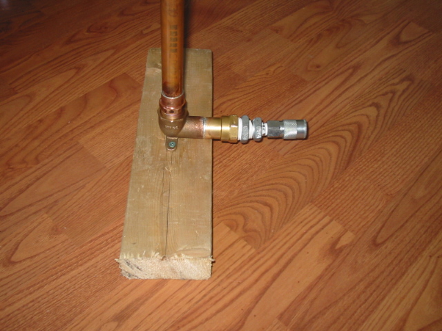

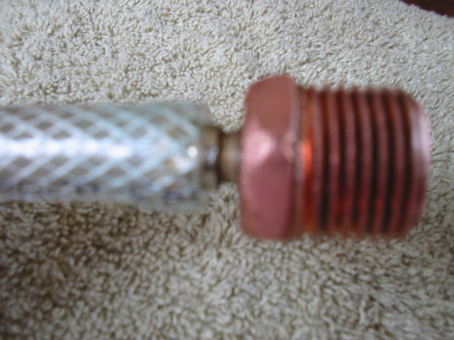

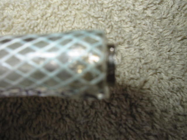

My new shock pump layout (not finished).
- Sticky_Tape
- Sergeant 2
- Posts: 1175

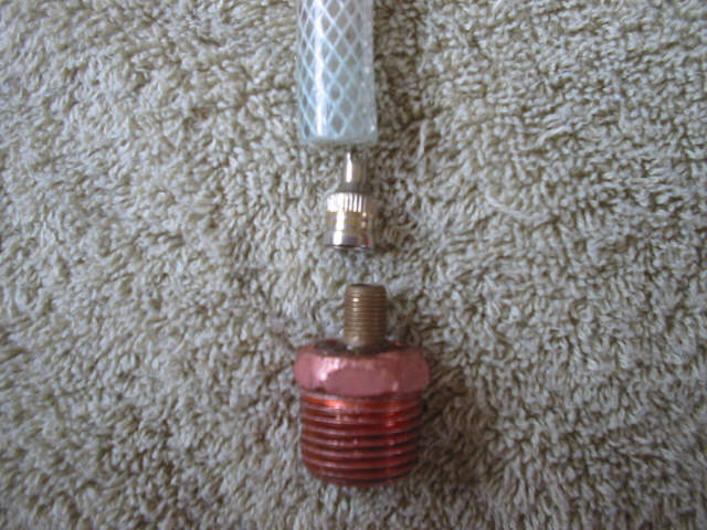

I didn't have a guage on my first pump the pump still functions the same I would count out the strokes I made and sometimes I would go a little overNice job man! Its really inspiring me to build one as well. But yeah I really need a high pressure guage before I start working at higher pressures:)

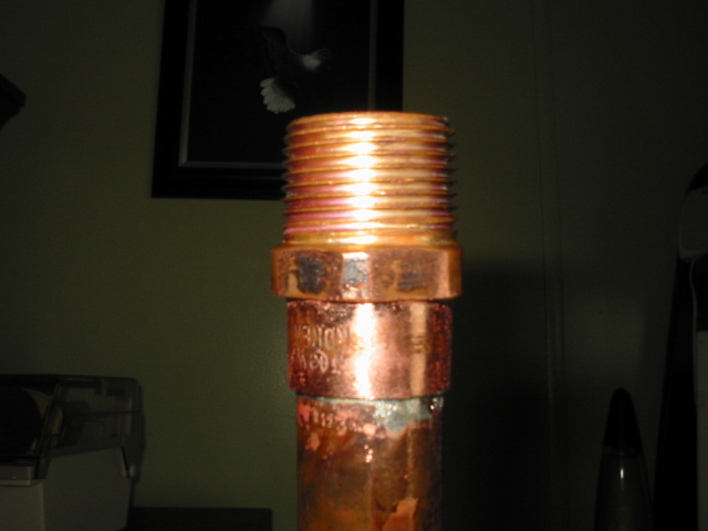

I already soldered in the washer looks kinda crappy (olny my second time soldering but the joint is good I put on enough flux and the solder got in there and yes I roughend up the pipe and fitting.) I don't have a spring yet.

That looks like it should work fine.
The piston should NOT be able to open the check valve. Air pressure will do this for you.
Keep up the good work. You're going to be REALLY happy with your new pump!

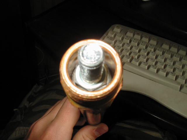

sorry for the double post but I was trying to grind the washers and WTF there is alot of vibration and the washers get grinded unevenly no it is not off center everything is aligned and I am using a drill press does anybody have any other methods of making plungers?

I'm sure your pump will make enough pressure to open the check valve.
What are you using to "grind" the washers? I get that you are using a mandrel, but are you using a file, stone or? What type?

8'' drill press on 3150 rpm, Mandrel, And 10'' Mill bastar d yeah that's what the file is called people give things pretty stupid names.

Slow it down (say 600rpm), and use a single cut mill file.
The file is chattering (jumping off of the surface and then biting down into it). Use light strokes and you'll get better results.

Well I got the washers filed they fit in the 3/4'' with about a .5mm gap I don't need to take a picture do I?
Slowing dwn the press really made it easier Thanks Gip.

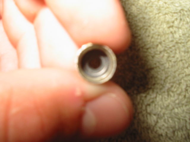

I had a brain fart today I was removing the core of a shrader from my new project and I noticed that there is a rubber washer on the inside of the shrader removal tool on the other side of the wassher there is the tiny tube that removes the core. the shrader removal tool can screw onto shraders so I think I am going o use it as a adapter for my minis.

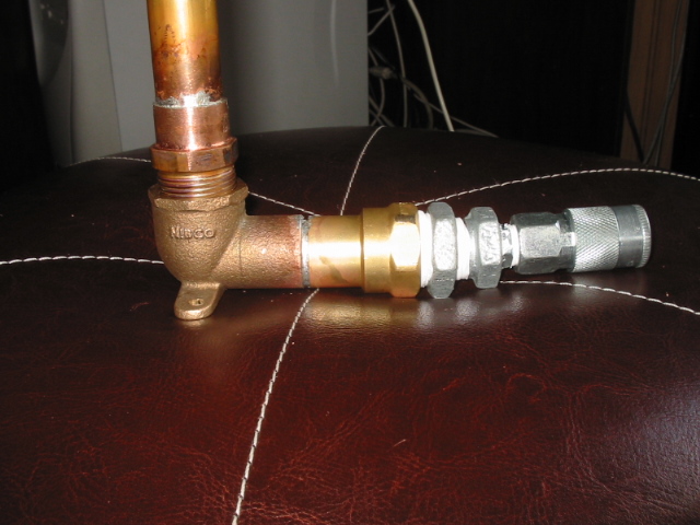

well I bought the elbow I needed now all I need is:
pump plunger to be made, 3/4'' - 1/2'' threaded reducer 3/4'' being threaded you may not know what it is, and 3/8'' spring.
don't nag me about a guage I don't know where to buy one.
I am going to make the pump adaptable to shraders instead of just quick connects.

Yesterday I took apart a old airsoft gun and took the spring from it I cut the spring to fit on the bolt and the check works great when I blow in less than 1psi with my lungs the check opens and when I suck back the check closes.
