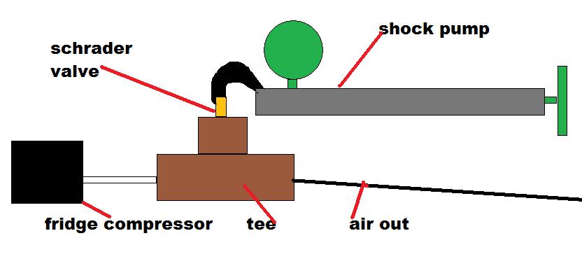

i got my shot pump like 3 day before i get my fridge and now don't use it
but need a 300psi gage on my fridge, i was thinking can i put a schrader valve in my fridge and then screw my shock pump to it as a gage
i have a schrader valve soldered into a 1/2inch threaded fitting that i tested to 300
do you think it will work or brake my pump?

Only if the pump has no check valve in between the gauge and out put hook up. Also depends on the seals/gauge pressure limits.

It should work because the check valve is before the pressure gauge so it would measure the pressure of the fridgy output. But only do it if the gauge goes high enough for the fridgy or it might break.

yer i dont know about the chek valve it have to have 1 to have one and i have all ready put a max to my pressur limet that i will ever go to to 300 and my shocke gage is 3000 ill give it a shot to moro
thanks guys
ps im hi like a kite and my net is caped so spell no chek is not working
edit: it worked

The gauge should unthread from the shock pump. It is most likely 1/8"npt so just thread it into a pipe fitting on your chamber.
yeah jsut remove it... if you want to keep it on the shock pump then just buy a new gauge (or used :-D) for the fridge compressor

If you remove the gauge and still want to use the pump temporailly you could plug off the gauge port.
